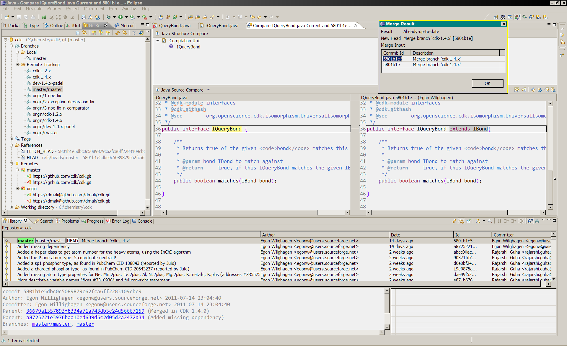

  • Now I want to merge all changes from master repository. For this I have added new remote "master" with ref specs "refs/heads/master:refs/remotes/master/master" (am I doing this right if I wand to fetch from master, but push to origin?)
  • When I invoke "Fetch" from remote master, EGit shows the empty window with fetch results (perhaps I did it several times, so ).
  • When I invoke "Merge" on "master/master" branch, I am shown the "Merge Result" window with two identical entries (why they are the same??). When I lick on OK, nothing happens.
  • However, when I select "Compare with" → "HEAD revision" for some source files, I see that they are different from HEAD.
How can I pull all changes up to "5801b1e5..."? Maybe I miss the trivial button "apply all fetched changesets?" (I haven't found anything so far in http:/wiki.eclipse.org/EGit/User_Guide).
Please, help.
Also I would be pleased if somebody gives a hint, why "master" is shown green on screenshot, "master/master" is grey and "HEAD" is white?

Yes, that's a good practice to create a new remote where you can fetch from.
I did the same as you and found out that the reason is that there was no new commit on https:/github.com/cdk/cdk between the time you cloned and the time you fetched, your repo already contains commit 5801b1e5.
> nothing happens.
This seems logical to me if nothing has changed on master and your local changes already have the latest change form master as ancestor in the history.
HEAD points to the currently checked out commit. What do you have checked out when you do that? If there are differences, this means that your working directory has non-committed changes.
What you do is correct: First fetch from master and then merge into your local master. But in the current situation there are no new changes in the master branch of the master repo.
master is a local branch, master/master is a so-called remote tracking branch. HEAD is a reference. You may have a look at the chapter "Remote Branches" in http://progit.org/book/ch3-5.html

Stefan, thanks for your comments.
Stefan Lay wrote on Fri, 29 July 2011 07:58
Well, I've cloned master repository https:/github.com/cdk/cdk long time ago, but indeed the local repository reports that the changes from master are in my repository, but why the merge result in not in my outgoing list of changesets?
Finally I've decided to start all over again (sorry, Git is blowing my mind). I've check out my clone (https:/github.com/dmak/cdk), added the remote repo, and invoked "Merge" on master/master. It was reported that merge worked OK. I am still in confusion: I see no outgoing changes. Does it mean, that my clone is connected to mater in a way, that I do not need to push back all changesets? So when I'll start committing, git will automatically link my commits as coming on the top of all fetched changesets (is it what "parent changeset" used for)?
That was the case. Thank you. On some reason I messed the things... If my above assumption is true, then I won't need validol.
