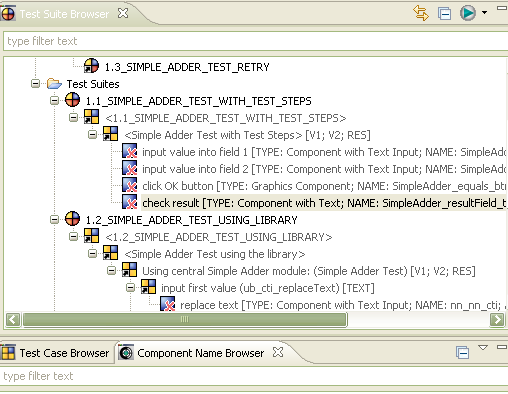

I started to play around and have the major problem how to specify input-fields. I always get for the 'input value into field 1' a red X in the Test Suite Browser resp. Test Case Browser. I tried the Cheat sheet and failed. Therefore I now tried the sample-project with the SimpleAdder2 and the problem remains. index.php/fa/3490/0/

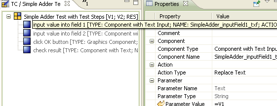

So, I have no idea, what is wrong with the configuration resp. where to configure it properly. As one could see, in the TC resp. the property-sheet for the test-steps it looks OK. index.php/fa/3491/0/
After I have launched the SimpleAdder, the app starts, but no input is done on the Adder. And that is what I've expected to some inserted text... Can anybody help me?

For your first question: Jubula 1.0 is available, and should be downloadable from the Eclipse site: http//www.eclipse.org/jubula/download.php
If that's where you got the setup from, then it should be version 1.0.
The screenshots look a bit strange to me. Normally the red crosses are propagated to the Test Suite and parent Test Cases as well. Perhaps refreshing the project would help.
Otherwise, you can check that all your data and all your object mapping is complete (the red crosses can mean both).
If it's data, it could be that your working language is set to a language for which there is no data, or you actually do have data missing at some level.
If it's object mapping, then you'll need to collect components from the application and map them to component names from your test:
http://help.eclipse.org/indigo/topic/org.eclipse.jubula.client.ua.help/html/manual/node155.html
Until a Test Suite is complete (i.e. no errors), you cannot start test execution. You'll be able to start the AUT, but you can't start the test until you have a runnable Test Suite.

I have an update from a meeting this morning: It would appear that the decoration on the Test Steps is indeed a display error. As far as I can tell from the example this morning, the Test Suites are actually complete and the red crosses on the Test Steps are just a cosmetic issue, as you said (we were also looking at the Samples project). I had been assuming that your tests were not executable (which is usually what the red crosses mean) and had misunderstood that the problem really was just in the display. We'll be entering a bug report for the issue.
