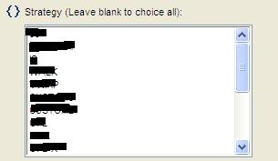

It works well with default parameter page of BIRT, parameter Strategy be rendered as multi-value listbox:
index.php/fa/3468/0/

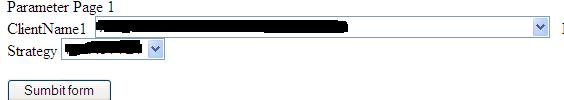

However, in the custom parameter page, parameter Strategy always be rendered as a single-value list box, which does not allow user to select multiple values:
index.php/fa/3469/0/
Is there anyway to have it rendered as a multi-value list box like in default paramter page of BIRT ?

Re: Multi-value cascading parameters in Custom Parameter Page [message #702546 is a reply to message #702053] Tue, 26 July 2011 10:00 Go to previous messageGo to next message
Can you log an enhancement for this?
Jason

Re: Multi-value cascading parameters in Custom Parameter Page [message #702549 is a reply to message #702546] Tue, 26 July 2011 10:04 Go to previous messageGo to next message
Sure, and same problem with regular parameters with multi-values
