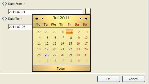

I already added a calendar widget to the BIRT viewer, and parameters with date type in BIRT default parameter page are now rendered with a calendar:
index.php/fa/3482/0/
But it does not work for parameters defined with BIRT tag library in a custom parameter page:
index.php/fa/3483/0/
