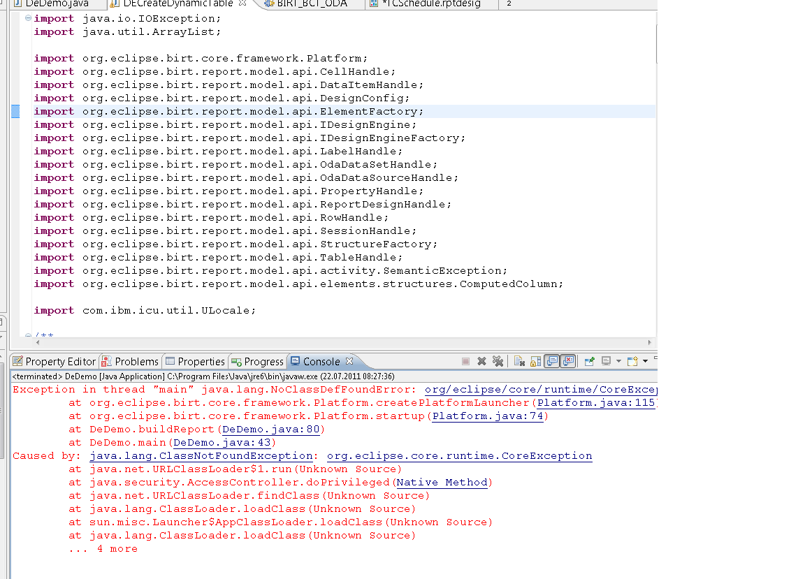

Hi people,
i really need help , i am new in this things from BIRT Very Happy , and i am trying to do my first API , i used the exemple API from the eclipse webseit but i got the next error. I used the new version from Eclipse and the last Version from BIRT
i will post the error and the code that i used
Thank you
error:
Exception in thread "main" java.lang.NoClassDefFoundError: org/eclipse/core/runtime/CoreException
at org.eclipse.birt.core.framework.Platform.createPlatformLauncher(Platform.java:115)
at org.eclipse.birt.core.framework.Platform.startup(Platform.java:74)
at DeDemo.buildReport(DeDemo.java:80)
at DeDemo.main(DeDemo.java:43)
Caused by: java.lang.ClassNotFoundException: org.eclipse.core.runtime.CoreException
at java.net.URLClassLoader$1.run(Unknown Source)
at java.net.URLClassLoader.findClass(Unknown Source)
at sun.misc.Launcher$AppClassLoader.loadClass(Unknown Source)
... 4 more

i also add and screen schot

Re: APIs error conection [message #699942 is a reply to message #699705] Fri, 22 July 2011 11:31 Go to previous message
Can you start a new workspace in Eclipse and import the attached
project? Make sure to unzip it first and when it is imported update the
build path to point at the jars from the birt
3.7runtime/reportengine/lib jars.
Jason

> try{
> Platform.startup( config );
> IDesignEngineFactory factory = (IDesignEngineFactory) Platform
> .createFactoryObject( IDesignEngineFactory.EXTENSION_DESIGN_ENGINE_FACTORY );
> engine = factory.createDesignEngine( config );
> }catch( Exception ex){
> ex.printStackTrace();
> SessionHandle session = engine.newSessionHandle( ULocale.ENGLISH ) ;
> try{
> //open a design or a template
> designHandle = session.openDesign("c:/tmp/testdeapi.rptdesign");
> designFactory = designHandle.getElementFactory( );
> buildDataSource();
> buildDataSet(cols, fromClause);
> TableHandle table = designFactory.newTableItem( "table", cols.size() );
> table.setWidth( "100%" );
> table.setDataSet( designHandle.findDataSet( "ds" ) );
> PropertyHandle computedSet = table.getColumnBindings( );
> ComputedColumn cs1 = null;
> for( int i=0; i< cols.size(); i++){
> cs1 = StructureFactory.createComputedColumn();
> cs1.setName((String)cols.get(i));
> cs1.setExpression("dataSetRow[\"" + (String)cols.get(i) + "\"]");
> computedSet.addItem(cs1);
> // table header
> RowHandle tableheader = (RowHandle) table.getHeader( ).get( 0 );
> LabelHandle label1 = designFactory.newLabel( (String)cols.get(i) );
> label1.setText((String)cols.get(i));
> CellHandle cell = (CellHandle) tableheader.getCells( ).get( i );
> cell.getContent( ).add( label1 );
> // table detail
> RowHandle tabledetail = (RowHandle) table.getDetail( ).get( 0 );
> CellHandle cell = (CellHandle) tabledetail.getCells( ).get( i );
> DataItemHandle data = designFactory.newDataItem( "data_"+(String)cols.get(i) );
> data.setResultSetColumn( (String)cols.get(i));
> cell.getContent( ).add( data );
> designHandle.getBody( ).add( table );
> // Save the design and close it.
> designHandle.saveAs( "c:/temp/sample.rptdesign" ); //$NON-NLS-1$
> designHandle.close( );
> System.out.println("Finished");
> }catch (Exception e){
> e.printStackTrace();
> Thank you comunity!!!
