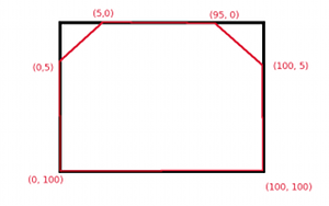

I do not think it is you algorithm that is wrong, but the width returned from the context.getWidth() has changed. I assume that the context.getWidth and context.getHeight returns the width resp. the height of the shape (the black line in the diagram below). When I resize the shape in the diagram by pulling the right side I would expect that as height of the shape would be return the same value as before (I had put some log statements into the code to check that), but the height gets smaller and smaller.
index.php/fa/3426/0/
