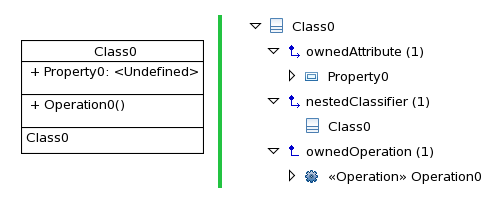

Re: How to create diagram elements programatically [message #725864 is a reply to message #725590] Thu, 15 September 2011 22:29 Go to previous messageGo to next message
Hi Neslepaks,
Sorry that I didn't describe my question clearly.
How to draw diagram elements with its owned diagram elements programatically? For instance, class-diagram-element with its attribute/operation/nestedClassifier-diagram-element.
In the attached figure, how to generate leftside diagram element from rightside model element programatically?
Thank you!
Yang
Re: How to create diagram elements programatically [message #725928 is a reply to message #725864] Fri, 16 September 2011 04:13 Go to previous messageGo to next message
Yeah, I understood your problem by reading it carefully. But still, unfortunately, I have no idea.
Re: How to create diagram elements programatically [message #730342 is a reply to message #725928] Wed, 28 September 2011 04:06 Go to previous messageGo to next message
Eventually, I finish this. Maybe it is helpful for some guys, so post the code as following..
1. get result of gef command execution.
Collection results = DiagramCommandStack.getReturnValues(commandDrop);
for (Object res : results) {
if (res instanceof IAdaptable) {
IAdaptable adapter = (IAdaptable) res;
View view = (View) adapter.getAdapter(View.class);
if (view != null) {
addCompartment(view);
2. get its relevant editpart and model object.
void addCompartment(View view){
EditPart cep = (EditPart) getGraphicalViewer().getEditPartRegistry().get(view);
//GraphicalViewer can get from DiagramEditor.getDiagramGraphicalViewer().
EObject eObject = view.getElement();
and then, can get compartment editPart from this one, with cep.getChildren().
3. add contained EObject to CompartmentEditPart.
Other is almost the same as code to add EObject to canvas in this post, except this time we drop to compartment area.
btw, http://wiki.eclipse.org/GMF/Tips is a good reference.
