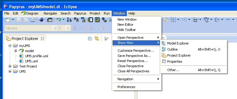

Re: Documenting UML elements in Papyrus [message #947773 is a reply to message #946955] Wed, 17 October 2012 08:20 Go to previous messageGo to next message
Hi Christian,
No unfortunately I do not see "Documentation" in the Show View dialog.. I have uploaded a screen capture of what I do see in the Show View dialog.

Re: Documenting UML elements in Papyrus [message #947980 is a reply to message #947773] Wed, 17 October 2012 12:29 Go to previous messageGo to next message
Hi, Keith,
This is the Show View menu, not the dialog.
What do you see when you choose the "Other..." option to open the Show
View dialog?
If you don't see the Documentation view in there, then you might check
the workspace log for any messages indicating that there's something
wrong with that view contribution, or that the plug-in that contributes
it has unresolved dependencies, or something.
HTH,
Christian

Re: Documenting UML elements in Papyrus [message #948214 is a reply to message #947980] Wed, 17 October 2012 17:38 Go to previous messageGo to next message
Hi Christian,
Turns out that the Documentation view does not appear when Papyrus is installed with eclipse 4.2 (Juno), but it is there when Papyrus is installed with eclipse 3.7 (Indigo).
Keith
