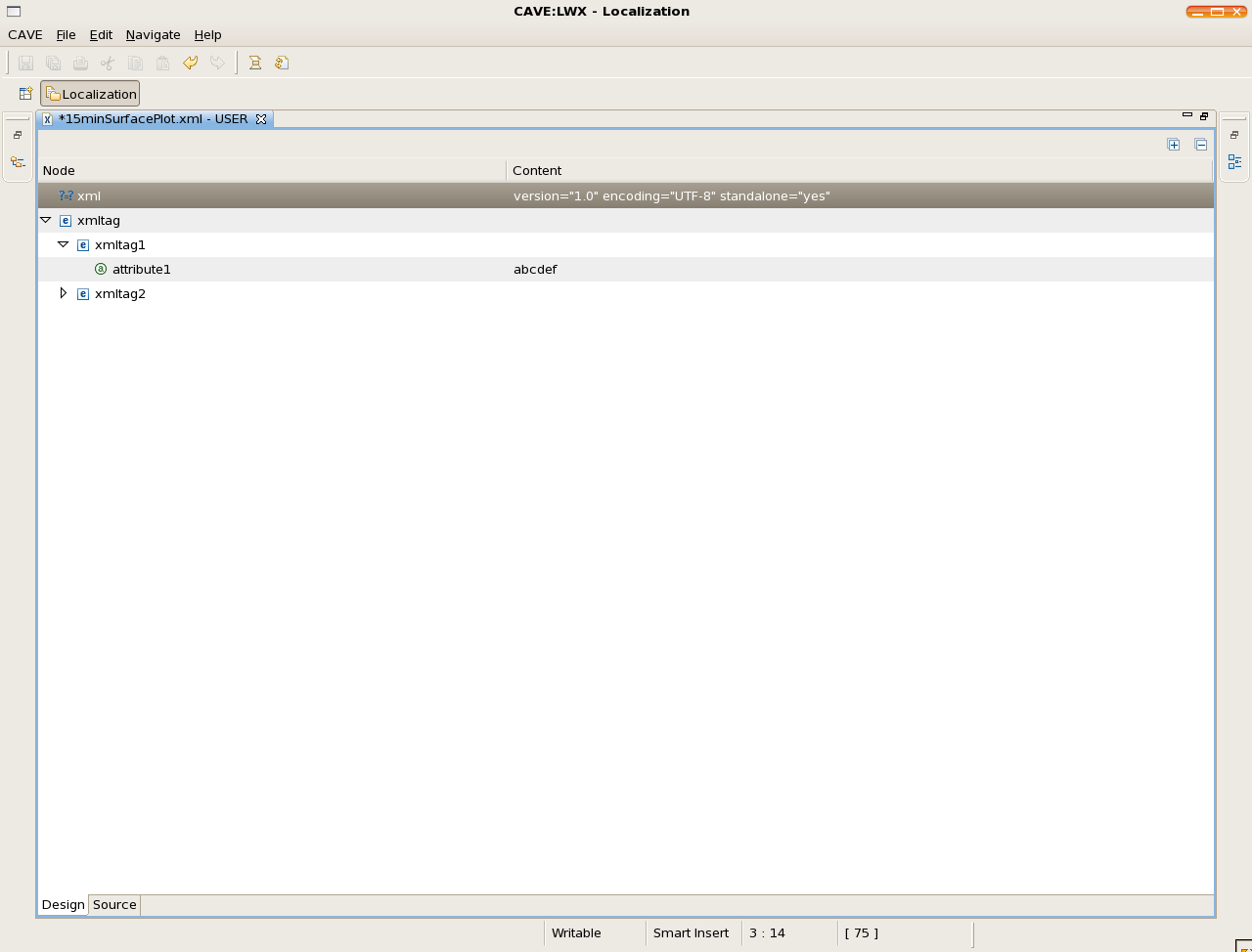

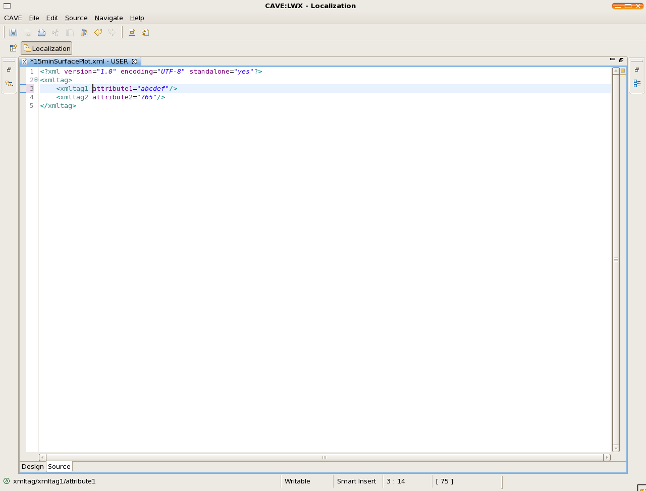

In my application, I have a file editing perspective which reuses lots of eclipse built in editors, the xml editor being one of them. The behavior I get is that when I open an xml file, it starts in the "Design" page. I edit an attribute and the editor shows the * in the title like it needs to be saved, but the save icons (which I include by referencing commandId=org.eclipse.ui.file.save in my plugin.xml) do not become enabled. If I then switch to the "Source" page, they get enabled and I can save. I do not get this issue when using Eclipse, it works as expected and I can save edits made in the "Design" page which makes me think I am not including a needed project or activating a context or doing something that might cause it to not work properly. I am using the EditorRegistry to open the proper editor based on file name so I am not using a custom editor or anything. The projections I have included specifically for xml editing are:

Here is a link to the original thread. I've also attached 2 screenshots of the different pages after an edit.
