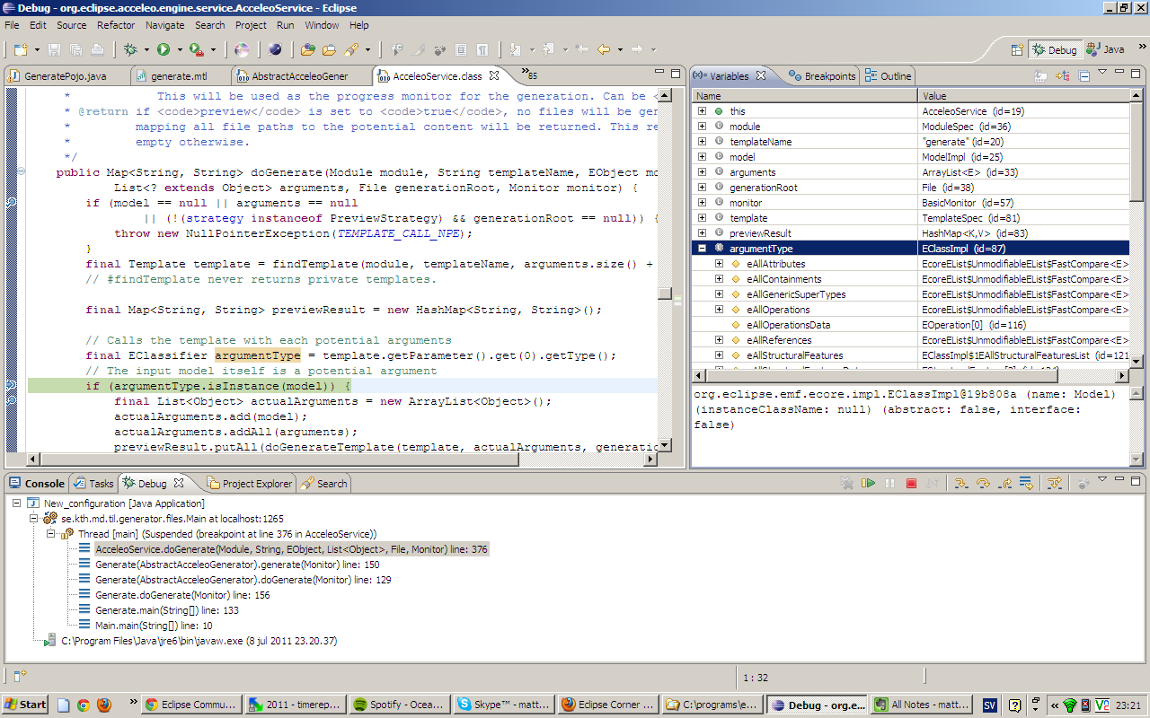

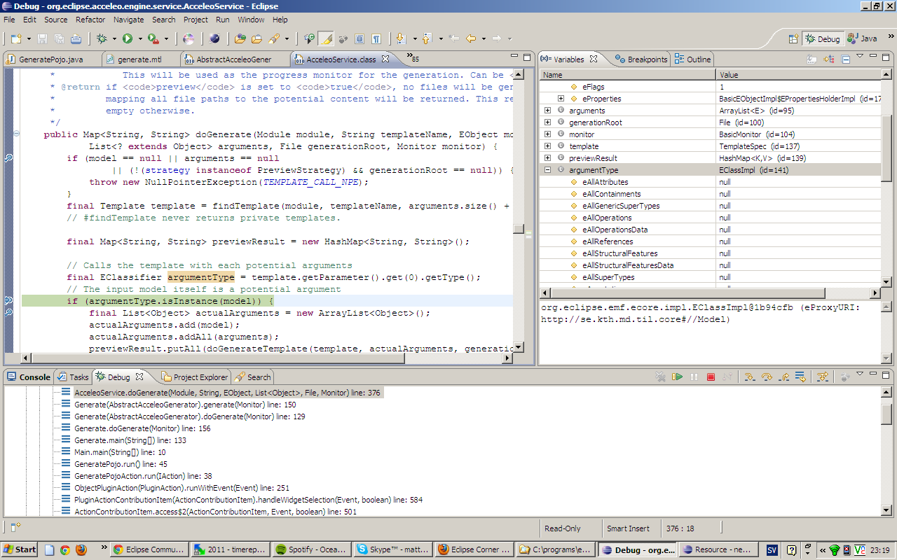

Re: [Acceleo] Launch as Acceleo Plugin does not work but Java Runner works [message #694583 is a reply to message #694328] Fri, 08 July 2011 18:16 Go to previous messageGo to next message
Hi Ed,
First, thanks for your answer. I am not sure I understood what piece of code I am supposed to debug.
Here is my attempt: I first looked at what goes wrong in (1) Plugin mode and then found the corresponding correct execution in (2) Java mode. Both test runs use the same input model and mtl transformation file.
The problem occurs in AcceleoService.doGenerate(..) when checking if the argumentType is an instance of the model. The if-test fails in (1) and succeeds in (2). In (1) the argumentType has a lot of null-Pointers and in (2) it is populated. Pictures showing the variables in debug mode are attached.
What can I learn from this? What do I need to change to make case (1) work?
Matt
  • Attachment: case (1).png
    (Size: 140.46KB, Downloaded 274 times)
  • Attachment: case (2).png
    (Size: 144.15KB, Downloaded 305 times)

Re: [Acceleo] Launch as Acceleo Plugin does not work but Java Runner works [message #694709 is a reply to message #694670] Sat, 09 July 2011 08:01 Go to previous messageGo to next message
Thanks!
You write that you dont fully understand my comments ... The big picture is the following: I am developing a plugin, which amongst other things, also calls an acceleo transformation. I am using the Java Code supplied with the acceleo project (Generate.java) to programmatically call the transformation. When this code is embedded in my plugin, no output is produced. Now when I run this exact same code (Generate.java) as java standalone, it works.
I am referring to AcceleoService.doGenerate(), and the line if (argumentType.isInstance(model))
I have continued debugging isInstance(): the problem is that all attributes of argumentType are null (so I cannot find which resource it belongs to). The model and its eClass seem to be ok.
When I run the same code as java, the attributes of argumentType are not-null.
I have also tried the same thing with another "self-made" metamodel with the same result.
Do I create my metamodels wrong? Is there some plugin conflict?
Matt
Re: [Acceleo] Launch as Acceleo Plugin does not work but Java Runner works [message #694715 is a reply to message #694709] Sat, 09 July 2011 08:38 Go to previous messageGo to next message
It sounds as if you have an unresolved proxy. The eStorage/eProperties
should tell you what wasn't resolved and so what you should help Acceleo
with by defining it in your registerPackages in your main Java file.
Ed Willink

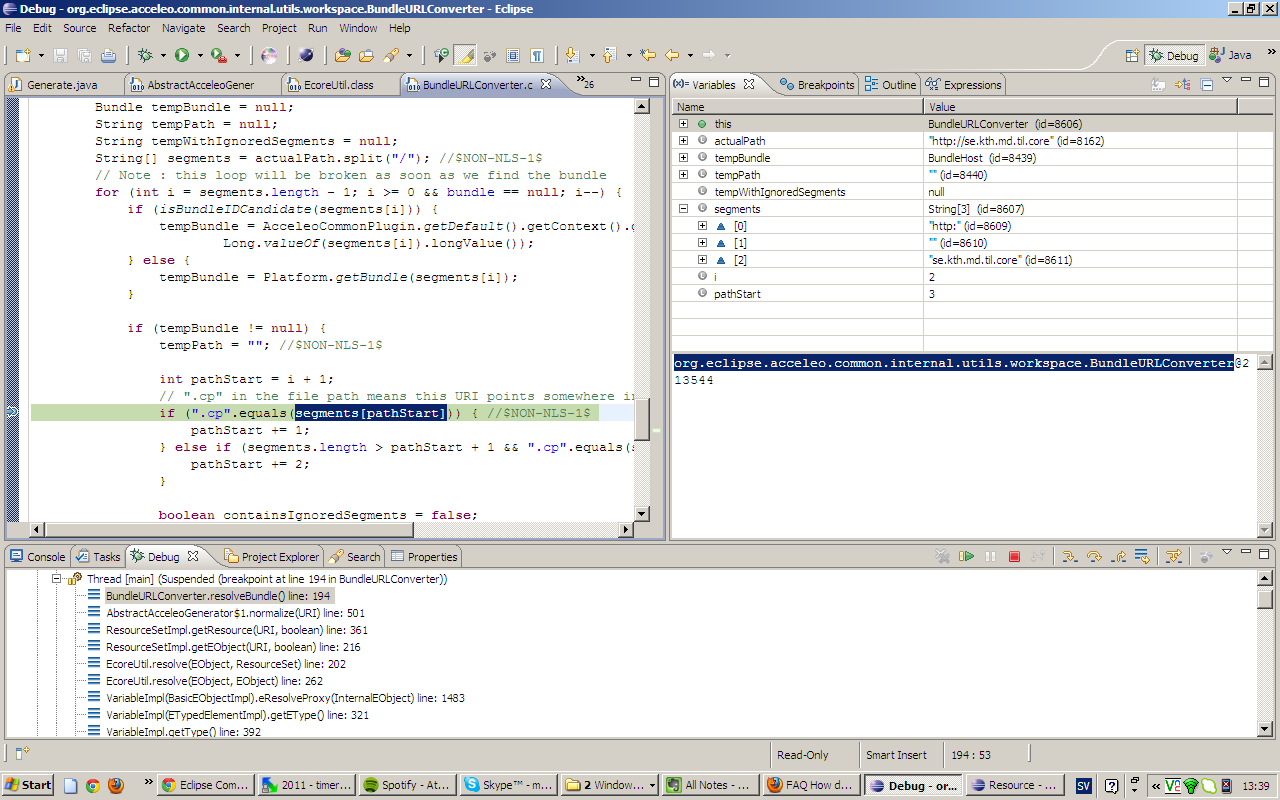

Re: [Acceleo] Launch as Acceleo Plugin does not work but Java Runner works [message #695260 is a reply to message #695013] Mon, 11 July 2011 07:45 Go to previous messageGo to next message
I debugged the proxy resolution.
There is a problem in
org.eclipse.acceleo.common.internal.utils.workspace.BundleURLConverter, line 194:
access to segments[pathStart] is out of bounds (see the attached screenshot).
This fails silently, due to an empty catch (RuntimeException exception) in EcoreUtil.resolve().
This problem seems to be not specific to my particular transformation/metamodel/setup. Any ideas for a workaround?
index.php/fa/3320/0/
  • Attachment: scrshot.png
    (Size: 124.23KB, Downloaded 1074 times)
