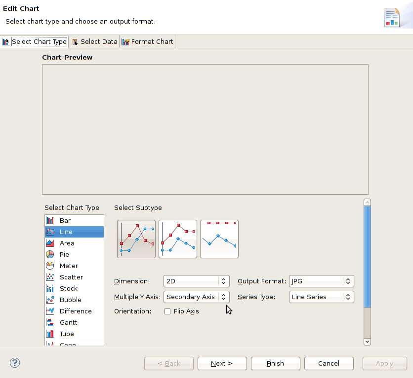

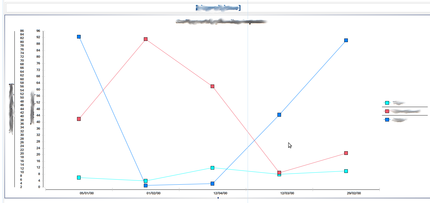

my birt version is:
Eclipse BIRT Designer Version 2.6.2.r262_v20110209 Build
<2.6.2.v20110214-1523>
Chart is LINE. Here some pics of example.
Thank you
best regards,
nicola

Re: secondary Y-axis on the right [message #694512 is a reply to message #694247] Fri, 08 July 2011 14:21 Go to previous message
In the third tab of the chart wizard select the second y-axis and set
its origin property to max instead of min.
Jason
