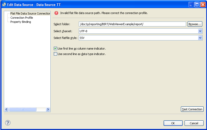

Iam getting the I/O Exception "org.eclipse.datatools.connectivity.oda.OdaException: An I/O Exception occurred when reading the file./doc1p/reporting/BIRT/WebViewerExample/report/NEC-20110614-PackageKATI.csv"
To see the full I/O Exception, check out the file attachments.
I changed the Flat File Path at the Data Source Options in the Report but it didn't work. (the selected flat file type was not a problem when I generated the reports on my local computer).
Iam not sure if this problems affects the selected folder at the Data Source Options or if it is somewhere else.
The file attachments include a screenshot of the I/O Exception, the Config-File which is used by the Generation-File and a screenshot of my current Data Source Options.

The Charset in the report is UTF-8 and the source files weren't, but this wasn't causing any problem under windows. We changed the source files to UTF-8 and didn't have the I/O Exception but another Error saying that the reports require a X11 Windows Server. We searched the Error-Message via google and were directed to the Birt FAQ Charts 2.2. There we found a solution for our problem:
