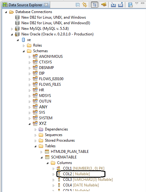

I am using the DTP Framework with Eclipse 3.5.2
I can connect to various databases including MySql , Oracle,
Sql Server etc. However some of the columns do not show proper datatypes.
E.g for Oracle the NCLOB datatype column shows blank as shown in attached screenshot.
Similarly if I access the table from Java code and try to get the datatype using ColumnImpl.getDatatype() function, then the datatype is returned as null for some specific datatypes(NCLOB in Oracle,NVARCHAR2() in Oracle,etc )
Is this DTP limitation or am I missing something ?

Problem Solved :
I was able to fix the issue by changing the typecode for the concerned data types
in the .xmi files from the plugins below
org.eclipse.datatools.enablement.msft.sqlserver.dbdefinition_1.0.0.v200906161800
org.eclipse.datatools.enablement.oracle.dbdefinition_1.0.100.v200906161800
org.eclipse.datatools.enablement.sqlite.dbdefinition_1.0.1.v201002041110
I would like to contribute the changes to the open source plugins. Please suggest the right way to do so.
