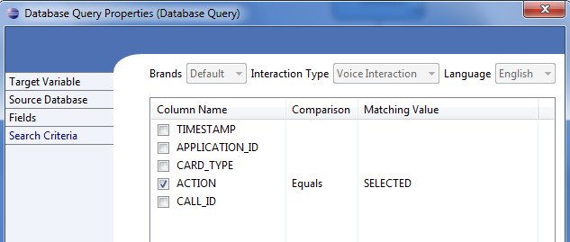

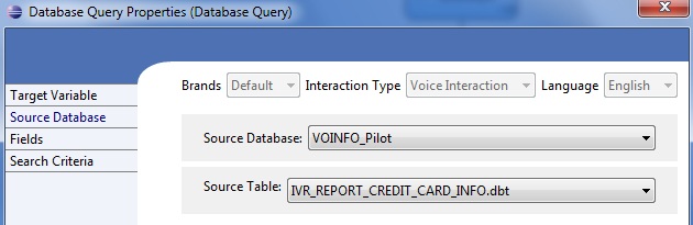

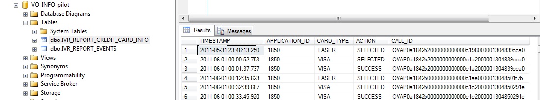

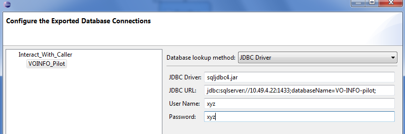

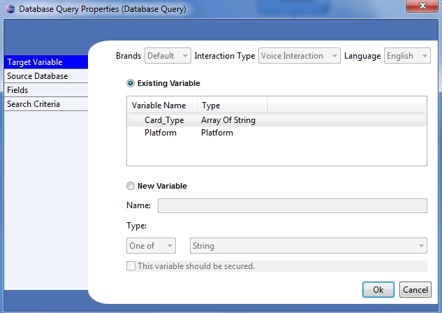

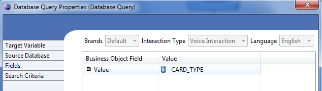

Re: Call drops when it gets to DB query module [message #694222 is a reply to message #694002] Fri, 08 July 2011 02:34 Go to previous messageGo to next message
Hi Randy!
Here are few screenshots of db module conf. and db export conf.
Hope it will help us to resolve this issue.
Brgds and thanks in advance!
Sergej
Re: Call drops when it gets to DB query module [message #694527 is a reply to message #694222] Fri, 08 July 2011 14:56 Go to previous messageGo to next message
Hi Sergej--
I think we've found the problem. In the db export screen, you're
specifying
sqljdbc4.jar
as the JDBC Driver -- what it's actually looking for here is a class
file name (hence the error you're seeing), whereas this is the actual .
jar file name. Try something like this:
com.microsoft.sqlserver.jdbc.SQLServerDriver
And here's the document I got this from:
http://msdn.microsoft.com/en-us/library/ms378526.aspx
I'm not 100% sure this is the right answer for what should be in that
field, but at least we've identified the problem, so hopefully this
helps you along the way.
Good luck,
Randy

Unfortunately i get the same error message even if i remove sqljdbc.jar from Dependencies folder Sad
ERROR|2011/07/11|07:31:20|p=Interact_With_Caller> java.lang.ClassNotFoundException: com.microsoft.sqlserver.jdbc.SQLServerDriver
I have CLASSPATH variable set to: CLASSPATH=.;C:\java\MS_Jdbc\sqljdbc_3.0\enu\sqljdbc4.jar
Attached is picture of java and tomcat environment.

Re: Call drops when it gets to DB query module [message #696512 is a reply to message #696341] Thu, 14 July 2011 02:54 Go to previous messageGo to next message
Here is also pic from MS SQL 2005 DB.
Hope it helps.
Brgds,
S.

more step that I didn't communicate to you (sorry about that). There's
a field in the OpenVXML database table file (which appears in OpenVXML
under the databases folder -- yours is IVR_REPORT_CREDIT_CARD_INFO.dbt)
which contains an invalid value as a result of the error (now fixed).
You can easily correct this manually or, if you'd prefer, delete the
table and the recreate it. However, fixing it by hand is pretty simple.
Right-click the .dbt file and open it with the XML editor. Towards the
top of the file, you'll see a name attribute with
simply remove the extension so that it reads
and then save the file.
Good luck, and please let me know how this works out for you.
Randy
