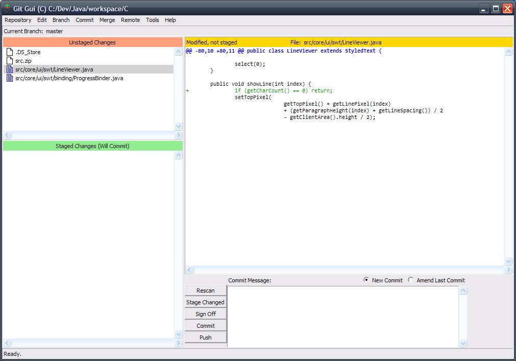

Is there a view/perspective in egit similar to Git GUI screen (see the attachment) where you can move items between the unstaged and staged lists, view the changes in the git diff format and commit the staged changes?
According to me this is the most comfortable way to progress with changes and I could not find it in egit.

Thanks, I see. It misses the file diff details on the same screen.
Review of changes is often required during staging. In my opinion displaying changes in the same screen would be more ergonomic, since it would require just 1 step to view next file changes instead of 3 steps: double click the item, open the diff screen, close the diff screen.
