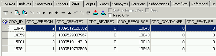

And an object list (see attachment) with cdo objects that should have been deleted, but instead have negative version numbers...
index.php/fa/3234/0/
Maybe, I am missing something...
The DBStore uses negative version numbers to indicate the deletion. It's an implementation detail.

In some cases the objects are deleted completely. In this case, the version is set to a negative number... Is it possible to instruct CDO to delete them permanently?
I have to check for the version whenever I query the db which is annoying if I have disabled audits/branches...
