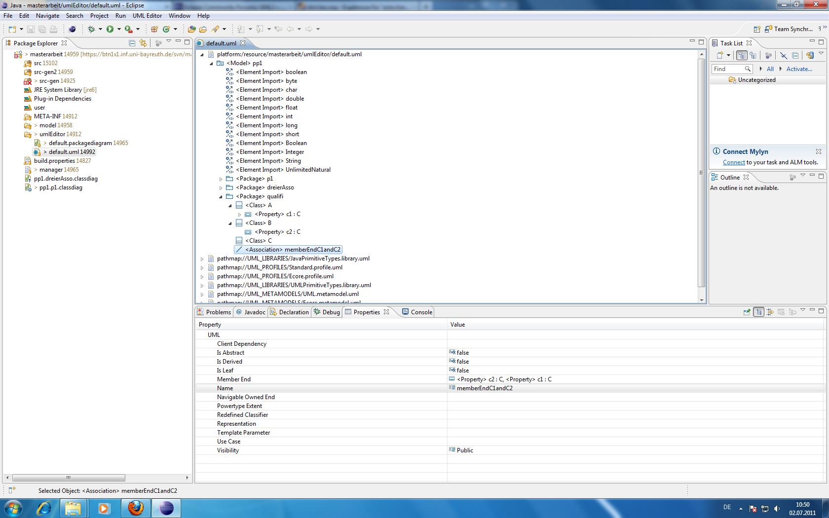

for example three classes A,B,C and one association (like in the picture):
class A has an property with type C and Class B has an property with type C, the associationsends of the association are the properties of the classes A and B. Now when the type of the property is deciding, then that would mean we have an reflective Association from the class C, although the owners of the properties are Class A and B?
that seems a little bit strange to me

It certainly seems strange to me.
Just because you have N information fields that you can enter, it does
not mean that you have a free choice for all of them.
Have you validated your example?
The usual case for a bidirectional association is that each end has the
opposite container as its type; two type choices are therefore constrained.
The extra UML specification complexity seems to arise from an ability to
have an association to a type that cannot own associationEnds/properties
so the association has to own the associationEnd/property on behalf of
that type.
I recommend ignoring the complex case and concentrate on the more
obvious bidirectional use case.

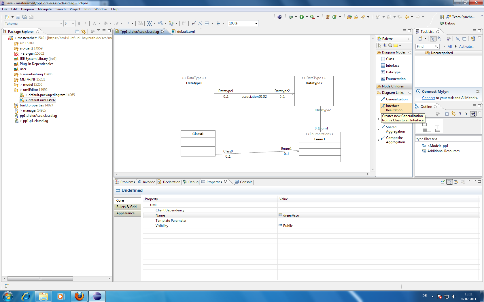

maybe i should go back to my mainproblem, i'm writing a codegenerator for an uml-editor the main question is (with an abstract view on association, for example in the uml-editor), is an association allowed between only classes and interfaces or is something else possible. like in the picture, is it possible to have an association between Datatypes or between primitiveType or bewtween enumerations (what make no real sense to me)
best regards stoehm

I think that associations from Enumerations are allowed; associations
associate.
Why shouldn't I associate an Enumeration with a Spannish table of strings?
[I am _not_ a UML expert, just someone who has scanned parts of the
specification occasionally.]
Ed Willink

you are right, there are no real problems when a enumeration or a datatype take parts in an association, but i don't think there is a need for that. a normal attribute should be enough for that case. for me it is a little problem, because in my codegeneration i have take care for the referential integrity, and i thougth during runtime it makes no sense to take care of referential integrity in case of datatypes or something like this.
so far i thank so for helping me to reflect the problem
best regards
stoehm
