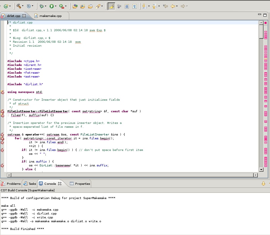

I had a similar problem - this is what the file would show once I opened it up:
index.php/fa/3201/0/
I fixed this by adding the proper includes path to the project settings, as they didn't exist before. It appears as though Eclipse has now gone and added in all of the proper include directories, because once I did that some new directories to search for includes popped up.
(Indigo clean install, 32-bit Linux)

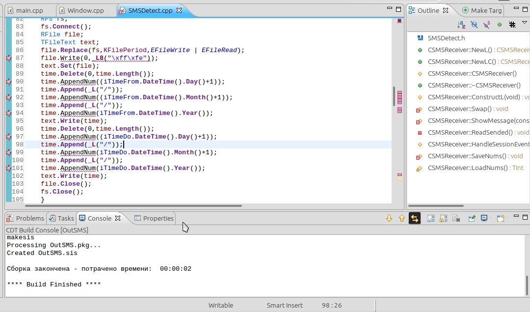

This error is too urgent for me. After the upgrade to version 8 began to appear such an error, although the build of the project goes well, ie it's not my mistake.
index.php/fa/3259/0/
