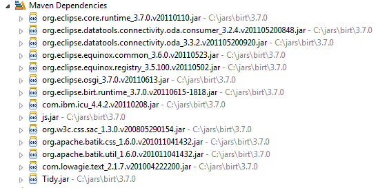

I'm looking for the Maven Dependencies (POM.xml) I could use for the attached image of jars I would use in my report.
So jar I just can't find something that would work.
I get a generic error ( which doesn't tell me which dependency to look for ,... unless it is in fact the pdf emitter I would need).
Thanks for all your help!
John.
