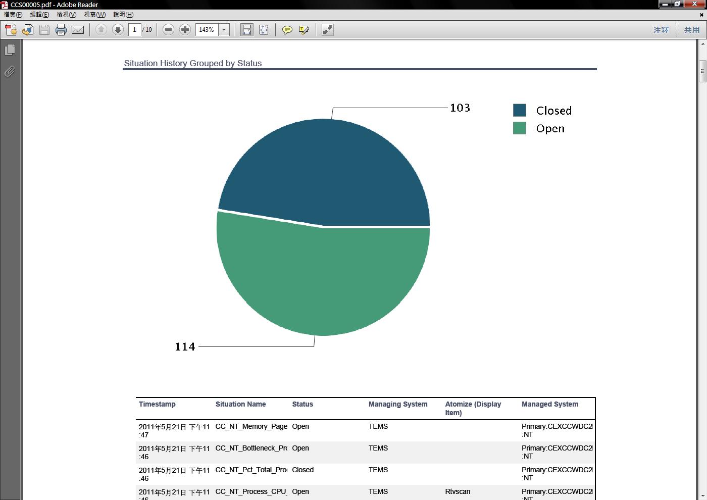

as attached, I found the column is not width enough and the word cannot wrap, is this normal because the word has no space between?
Or is it related to font problem? but I check that my rpt, the font property is empty, so I don't know what fonts my report is using!!

Do you want the text to wrap? The time stamp column appears to be
wrapping. If you do not want it to wrap try creating a style with the
text block whitespace set to nowrapping. I think this has been fixed in
later versions of BIRT. Also on the general properties of the report
you can change Layout Preference to Fixed Layout instead of Auto.
