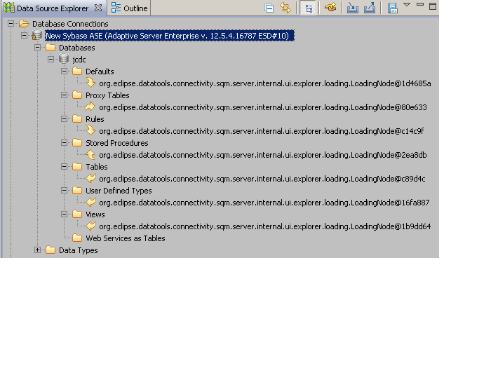

Dear Eclipse users,
I am trying to use the Eclipse DTP to connect to a Sybase ASE database.
My driver is "Sybase XA JDBC driver for ASE 12.x"
My jar file for the connection is -> jconn3.jar
Driver class -> com.sybase.jdbc3.jdbc.SybDriver
IP -> (an IP address)
database name -> (database name)
port -> 5100
userid & password
I also give the property -> "JCONNECT_VERSION=6"
Now, I get a "successful" ping when testing the connection.
Then I connect, and it all appears to be fine.
But I've noticed that there's this "Loading Core Provider" background process running, and this takes about 20 minutes to finish (maybe about 10 processes).
(see attachment, ".png" file)
During this time, it really slows down my "Eclipse usage" and sometimes locks it up.
I have 'successfully' done a query with this, but again these processes seem to be taking forever. I've used Eclipse & DTP for other databases, like DB2, Informix, and have not had this problem.
Can anyone give me some suggestions on how to correct this?
When I use "RapidSQL" or Aqua Data Studio to connect, they connect 'automatically' and there's no slow-down (but I know they are using "Windows drivers").
My 'software' being used is:
JBoss Developer Studio 4.0.0.M2 (Eclipse 3.6.0)
Eclipse Data Tools Plugin -> 1.8.0
Any comments, help, or suggestions would be greatly appreciated!
Thanks!
J

Are you connecting to an actual ASE 12.x database with the ASE 12.x driver? Or is it a newer version of the db?
Unfortunately at this point we don't have anybody supporting the Sybase support, so I don't know that we can fix this even if we discover the problem. I no longer have access to Sybase dbs.
Re: New connection profile to Sybase ASE database..(problems) [message #693231 is a reply to message #690466] Wed, 06 July 2011 00:51 Go to previous message
Yes, I am connecting to the actual Sybase ASE database 12.5.4
Again, I'm using the JDBC driver in jconn3.jar
I guess for now, I'll still use Aqua Data Studio.
