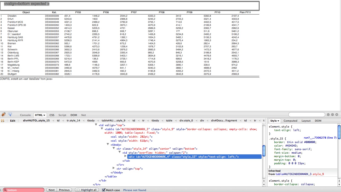

I format a text-element within a grid and I want to set a valign=bottom.
If I do that (via birt-styple xor css-style) than:
* looks the ReportDesigner very well (@see reportdesinger-screenshot)
* but if I preview my report into browser (firefox/chrome/safari) than all valign=top (@see preview-screenshot)
* and if I export my report to pdf than I got the same problem.
I want to configure this via css-file. What must I do? ( @see my.css what not worked at runtime)
* I added valign and vertical-align on many selectors.
I use birt-2.5.2(gallileo) on macosx (leopard) with java-1.6
Many THANKS for each reply.

This looks like a bug. Can you please log a bugzilla entry for this?

Thanks for this quick reply.
I've looked to birt-bug-repo and found this: bugs.eclipse.org/bugs/show_bug.cgi?id=344938
* Its looks like same problem.

In 2.6.2 I got this to work in pdf just not html. It may be good to add
a sample report for the devs on that bugzilla entry.

Jason Weathersby wrote on Thu, 16 June 2011 10:50
Many thanks to Jason
* I will upgrade my birt-runtime-dependency to 2.6.2 and test it.
* And I will try to seperate the problem to a single report for bugzilla-ticket.

I added a sample report to birt-bug-report(ID=344938). (same files I attached here)

A quickfix for the failor:
* define css-selector: text-notop
.text-notoyp{padding-top: 20px}
* import/reload css-file
* apply 'text-notop' style to related element
