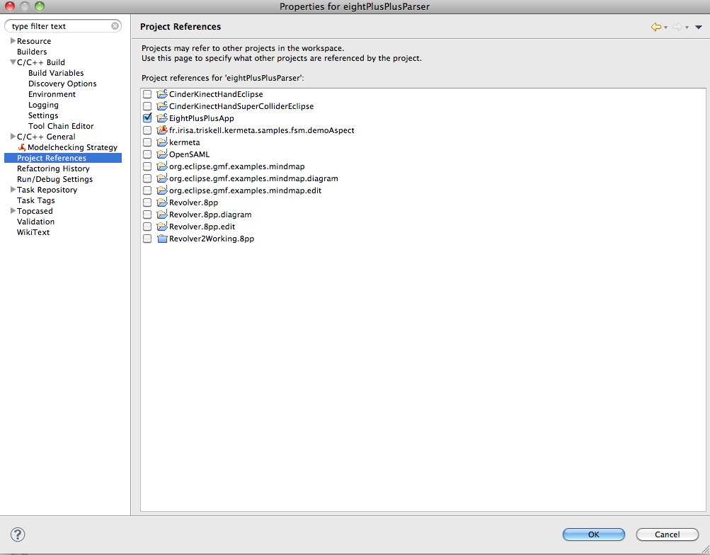

First this EightPlusPlusParser project says it references EightPlusPlusApp project like this:
index.php/fa/3048/0/

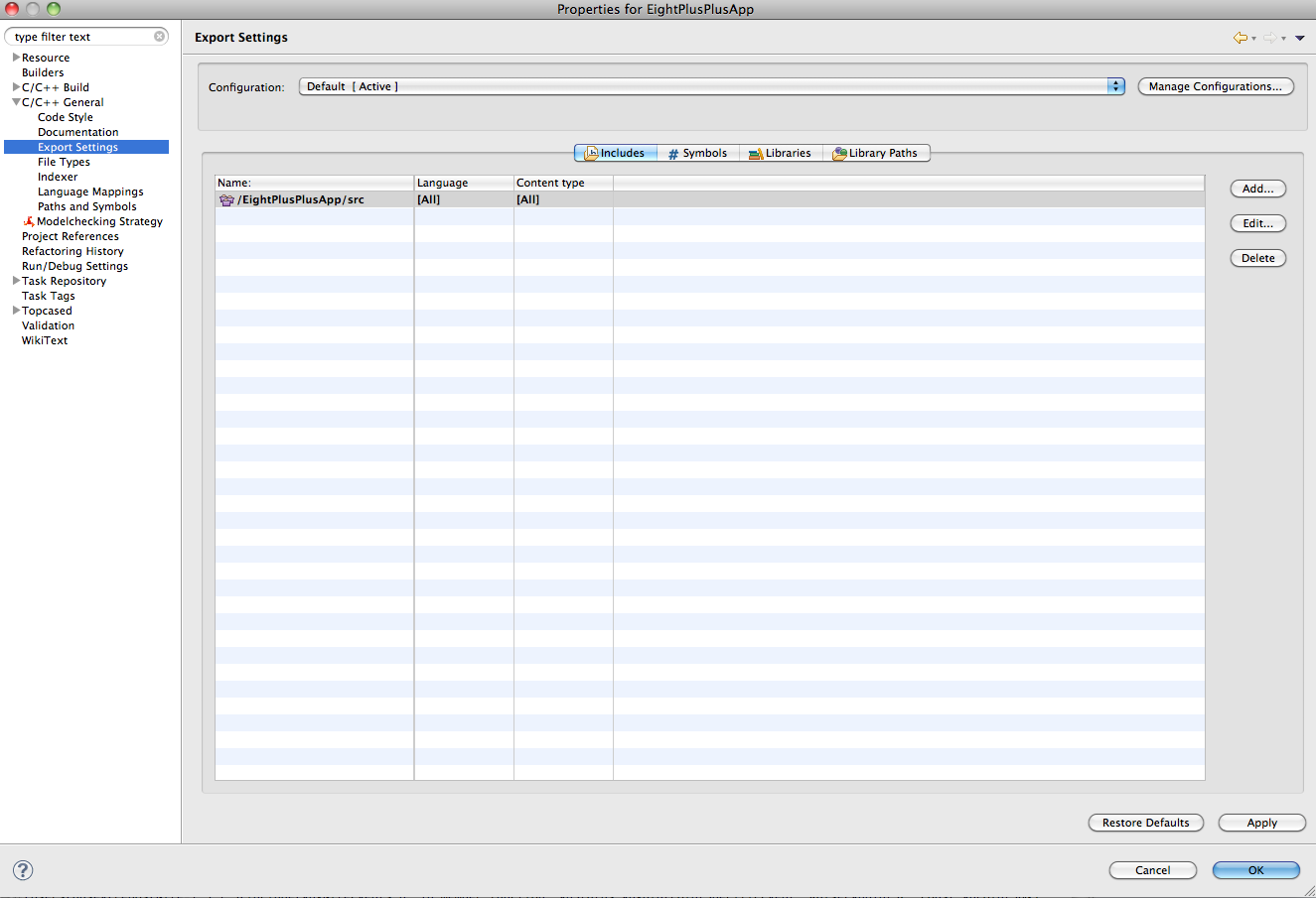

EightPlusPlusApp says it exports its entire src directory, which contains the said ITracker.h file:
index.php/fa/3045/0/

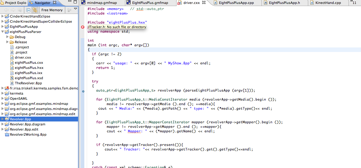

When the EightPlusPlusParser is built, it triggers the EightPlusPlusApp to build, so I assume that referencing at least partially works. However the compiler still cannot find the said ITracker.h:
index.php/fa/3046/0/
This is what I mean by saying "referencing other projects does nothing".

Thanks for the detailed description. That helped a lot. In your EightPlusPlusParser project you must open Project Properties->C/C++ General and in the tab "References" you must select your EightPlusPlusApp project. This will then automatically add the EightPlusPlusApp include paths (see the Include tab).
The Project References on the first page of the Project Properties are "platform properties" and do know nothing about C/C++ projects. They are only important for the build order.
I think this is all correctly described in the help page. Nevertheless I must admit the double usage of project references is confusing.
