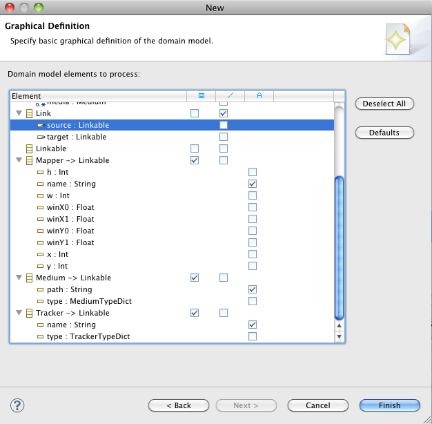

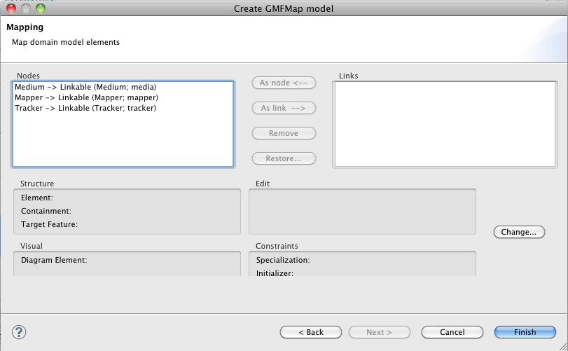

Specifically, while using the dashboard to combine the graphical and tooling definition, the links are absent from the available items in the wizard dialog (attachment Linksabsent.png):
http://post.scriptum.ru/svalka/gmf/Linksabsent.png
However, I have defined them in both graphical (attachment gmfgraph.png):
http://post.scriptum.ru/svalka/gmf/gmfgraph.png

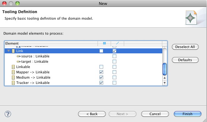

and tooling (attachment gmftool.png):
http://post.scriptum.ru/svalka/gmf/gmftool.png

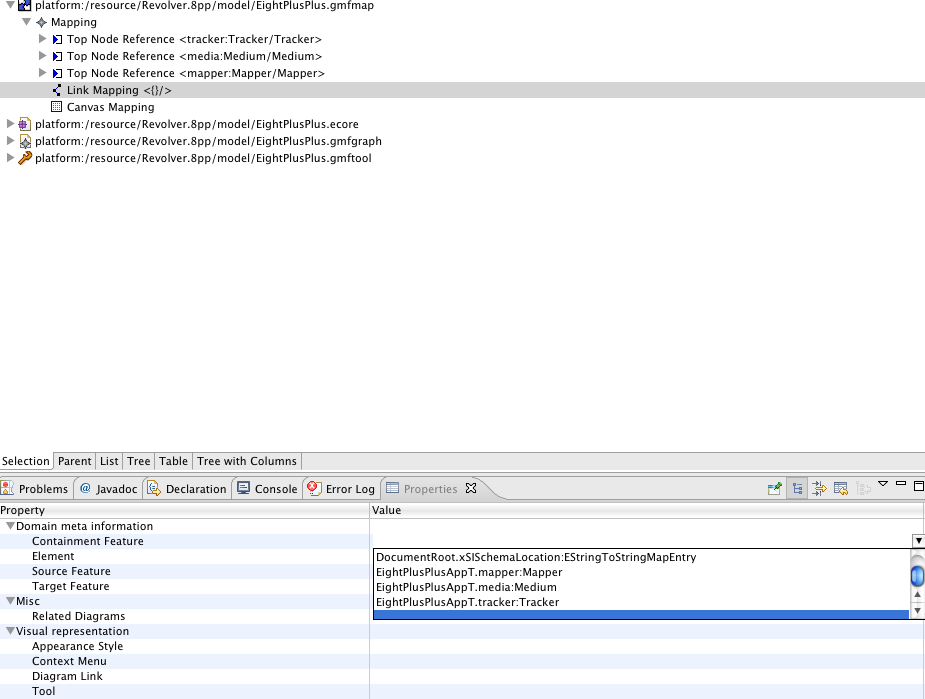

If, on the other hand, I will manually add the link to the gmf mapping definition, the Containment feature drop down does not list the Link model either (attachment manuallink.png):
http://post.scriptum.ru/svalka/gmf/manuallink.png
and proceeding without it makes the mapping invalid.
