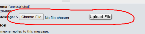

Once you are done with that, you should get the full reply screen and click "Choose File" and once you have chosen the file, click "Upload File":
index.php/fa/2931/0/

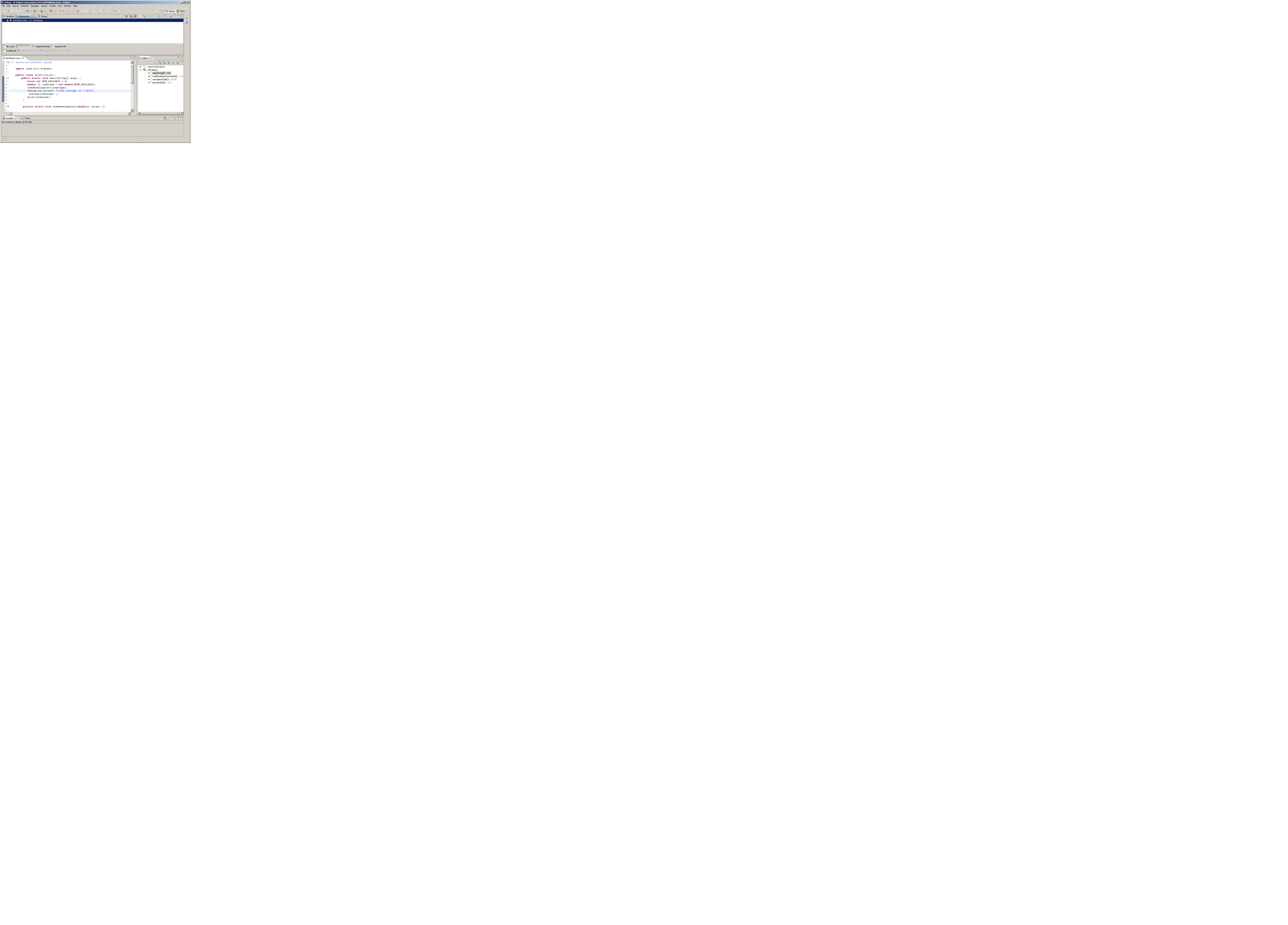

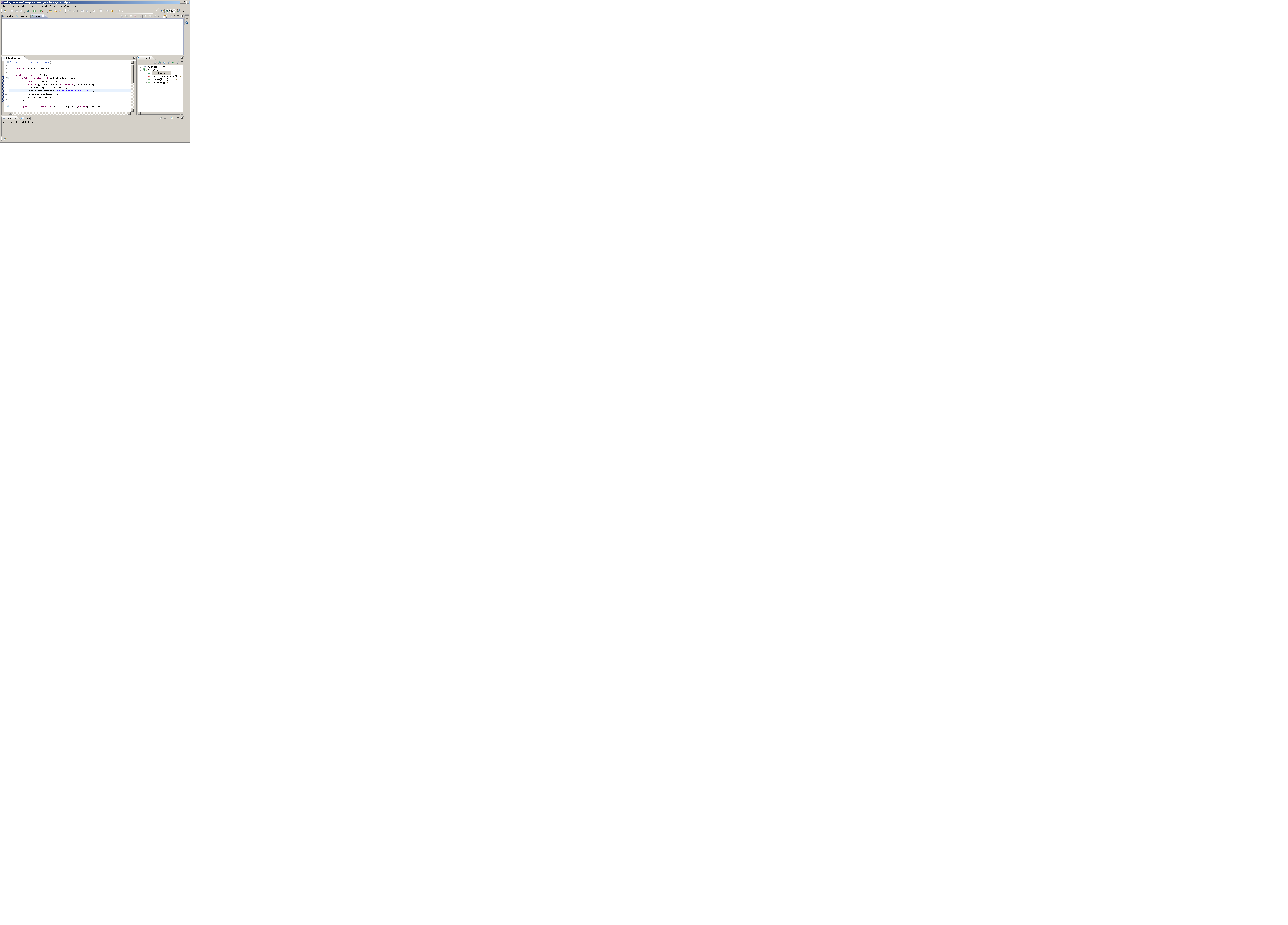

Re: Step Into grayed out in Debug perspective [message #676478 is a reply to message #676345] Sat, 04 June 2011 14:54 Go to previous messageGo to next message
thanks for the info. Here are two screens. One shows the breakpoint and the other the debug perspective.

Re: Step Into grayed out in Debug perspective [message #676786 is a reply to message #676478] Mon, 06 June 2011 10:21 Go to previous messageGo to next message
You have to be stopped at a breakpoint in order for the step buttons to work. You don't appear to even have a process running. You need to launch your application in Debug mode to debug it.

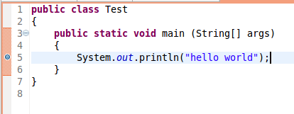

Also, how are you launching the debugger? Again, you need to make sure you set a breakpoint by either double-clicking in the area on the left of the editor or right-click > toggle breakpoint. Here is a screenshot where you can see a breakpoint is set. I set it by double-clicking in the orange area on the left of the editor:
index.php/fa/2977/0/

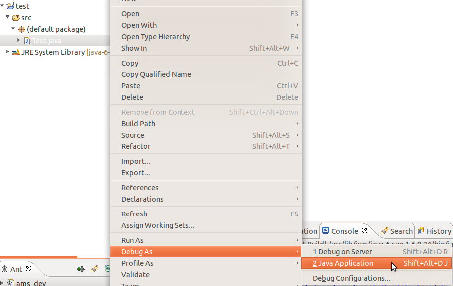

Then I would just recommend you right-click on the Java file > debug as > Java application like this:
index.php/fa/2978/0/
