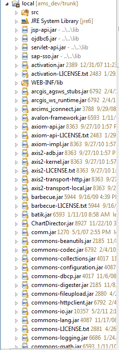

- If you checkout the project on a Windows machine (which everyone else uses) then the project works and can be built, but all of the jar files show up as children of the main project directory like this:
index.php/fa/2926/0/
Thus, in order to move from the src directory (where the .java files are stored) to get to other files (.jsp, .js, images, etc.) you have to scroll past all of the jar files in the classpath. I have tried deleting the project and checking out again, refreshing, closing/opening the project but nothing seems to work. The .classpath file references them correctly as lib resources like so:

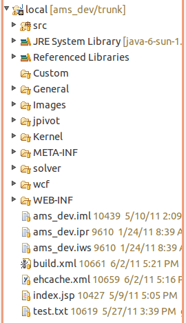

- If you checkout the project in Linux (or add the jar files to the classpath manually on any platform) then Eclipse places the jar files under the "Referenced Libraries" section of the project like this:
index.php/fa/2927/0/
This is certainly much better than the behavior described above but I still don't like it because it winds up removing the WEB-INF/lib directory from the "Package Explorer" view. Subclipse doesn't seem to play nicely with this, and if you change a jar file you no longer see the little asterisk on the jar file name showing that it is modified. Instead, you have to switch to the "Team Synchronizing" perspective and synchronize with the repository.

Re: Managing classpath (in general and with Subversion) [message #676407 is a reply to message #676302] Sat, 04 June 2011 04:10 Go to previous messageGo to next message
B Mayes wrote on Fri, 03 June 2011 11:03
1. Is there any way to fix the way that Eclipse on Windows displays the jar files when the project is checked out? At a minimum, I need to get the jar files to be displayed under the Referenced Libraries section instead of showing up as children of the main project node.
It seems to me as if you are using 2 different views, Project Explorer(windows system) and Package Explorer (linux)

Re: Managing classpath (in general and with Subversion) [message #677588 is a reply to message #676407] Wed, 08 June 2011 17:41 Go to previous messageGo to next message
Ah yes...you are correct! There is a subtle difference between package explorer and project explorer. I opened the package explorer view on Windows and it shows up just fine. Thank you! I was wondering why my boss didn't have this problem on his system when he checked out the project from my system.
