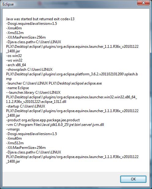

I am trying to work with Eclipse Helios on my x64 machine (Windows Vista) but it just doesn't cooperate. I have Helios EE x64 installed (latest version) as well as JDK 1.6.025 (x64) installed

Whenever I tried running eclipse i get exit code=13 (required java version=1.5)

Re: Eclipse fails at startup error code=13 [message #675351 is a reply to message #675257] Tue, 31 May 2011 04:57 Go to previous messageGo to next message
Java seems to be having problems with the ! character in the path. Try using a different directory.
Re: Eclipse fails at startup error code=13 [message #675370 is a reply to message #675351] Tue, 31 May 2011 05:56 Go to previous message
You are a genius! (I hope the exclamation mark wont cause trouble this time)
