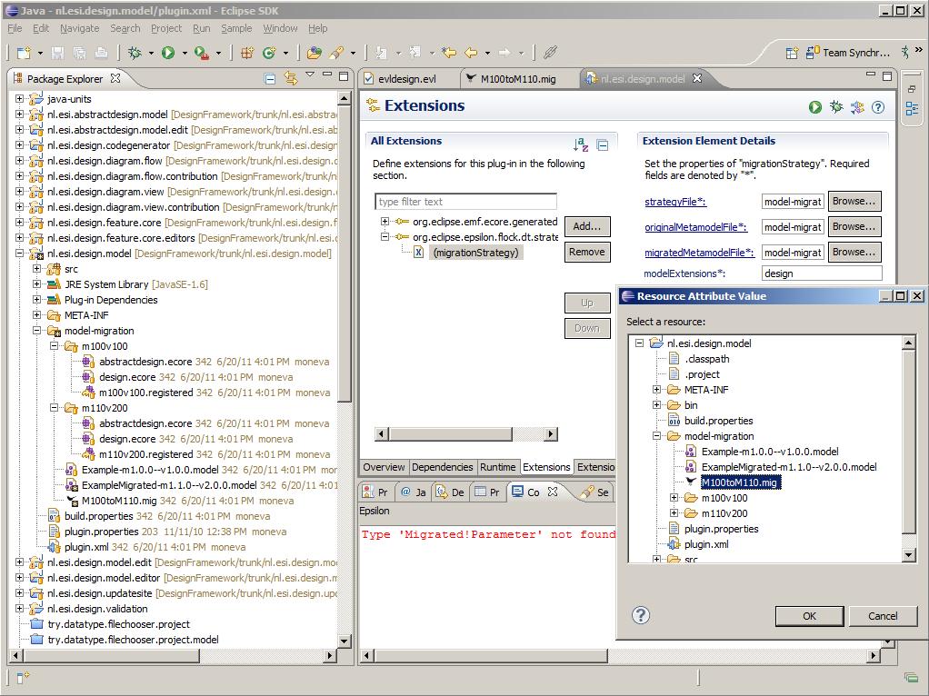

Re: [Flock] error while executing migration strategy distributed via plugin [message #684935 is a reply to message #675463] Thu, 16 June 2011 09:49 Go to previous messageGo to next message
Dear Louis,
And now about the bundle.getResource(...) problem.
The current situation is as follows: I have two examples - small and big. In the small everything works fine - with "Epsilon Flock Migration Strategy" Run Configuration and via Flock extension point. In the big example - the "Epsilon Flock Migration Strategy" Run Configuration works fine, but the Flock extension point ends with the bundle.getResource(...) error.
The plugin.xml files...

Re: [Flock] error while executing migration strategy distributed via plugin [message #686101 is a reply to message #684916] Tue, 21 June 2011 13:52 Go to previous messageGo to next message
Hristina Moneva wrote on Thu, 16 June 2011 09:22
Dear Louis,
Thanks for the answer! But... I still cannot manage. The example you gave in your reply was exactly the opposite of what I need - just switching the from and to metamodels. It should be:
FROM:
class Block {
  attr String name;
  attr int multiplicity = 1;
  val Property[*] hasProperty
TO:
class Block {
  attr String name;
The goal of the migration is to create new property with name "multiplicity" and value as it was in the original model.
The MIGRATION STRATEGY I use is as follows:
migrate Block {
	for (multi in original.multiplicity) {
		var par = new Property();
		par.key = "multiplicity";
		par.value = multi.toString();
		par.println();
		migrated.hasProperty.add(par);
The result is that a new Property element is created ("par.print()" supports my statement that the attributes are created correctly), but no attributes are set (based on the resulting migrated model).
What is the correct way of setting the attributes?!
Hi Hristina,
Thanks for the very clear descriptions of what you'd like to achieve.
The problem is that the type Property is ambiguous: this could refer to the Property in the original model or in the migrated model. We need to be more specific, and indicate that we wish to refer to Property in the metamodel of the migrated model:
Migrated!Property
Admittedly, EOL and hence Flock should probably issue a warning here, as the ambiguity can cause much confusion (as in this case). I'll open a bug to fix this.
Finally, it's worth noting that the for loop is not necessary here: original.multiplicity is always an integer, and iterating over an integer is the same as executing the loop once. So, the final code looks like this:
migrate Block {
	var par = new Migrated!Property();
	par.value = original.multiplicity.toString();
	par.println();
I'll take a look at the extension point problem now too.
Cheers,
Louis.

If so, are you certain that the path to the Flock migration strategy file in the plugin.xml below is correct?
Yes, I am, because I use the Browse button to select the file (not just manually typing it in the plugin.xml), as you can see in the screenshot (the attached file).
Maybe it should be "model-migration/M100toM200.mig"?
No, because such file does not exist. The previous argument holds here as well...
In the screenshot you can see the file hierarchy I use (in the Package Explorer), as well as the selection of the only strategy I have...
About the fact that the simple example I sent you works at your computer - it is the same here. The problem is that identical, but more complex case - does not!
I have no idea how to solve it... I will try with a clean Eclipse installation and importing there anew all the projects. I have no other idea for now... If nothing helps, I have still two options: to use other migration technology or sending you my complete project set (which I hesitate). I will inform you if I have some progress. I would appreciate if you have any other ideas...
Greetings,
Hristina
PS: in the screenshot you can also see the error message for the migration strategy itself on "Migrated!Parameter" (in the simple example should be "Migrated!Property")
index.php/fa/3211/0/
