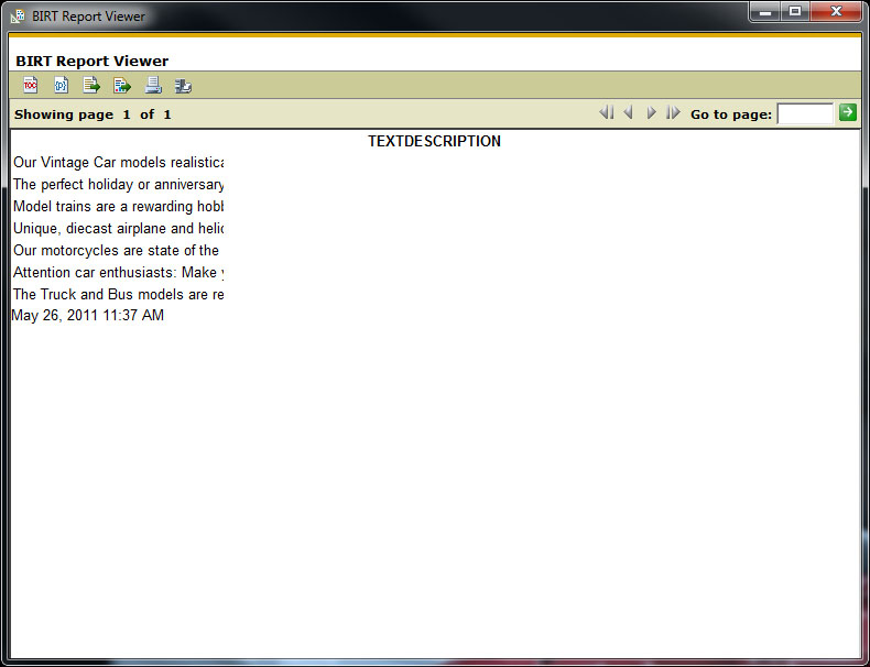

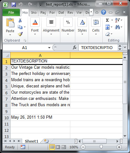

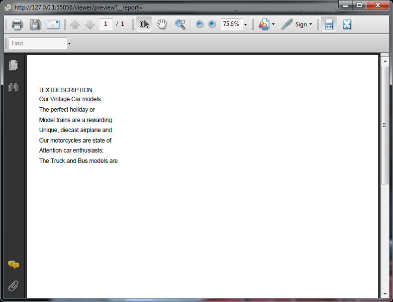

I'm developing some inventory reports in the BIRT Report Designer 2.5.1. Some of the descriptions for these inventory parts are pretty long, and I would like to show as much in a one-liner as possible, so I've been trying to clip them in the PDF-generated reports.
Most of the research I've done seems to involve making an external application using the BIRT API with wrapping (i.e. "options.setOption(IPDFRenderOption.PDF_TEXT_WRAPPING, true);") and preventing clipping, but in my case I'm trying to do the opposite; that is, make the text clip within the report designer.
I made a NoWrap style class with Whitespace set to No Wrapping, and the clipping works with the XLS and HTML formats. (Why doesn't it clip by simply setting No Wrapping in the Advanced properties for the object? That's another topic altogether.) But when it comes to the PDF, text output will stop on a space or hyphen in the PDF, which is undesirable.

Can you try the attached report?
Jason
> I've tried putting in the code I found in a few places under the Script
> screens (e.g. report/initialize, table/onCreate, row/onRender, etc.),
> but it's still not doing a no-wrap with clipping.
> var options = new PDFRenderOption();
> options.setOption(IPDFRenderOption.PDF_HYPHENATION, false);
> options.setOption(IPDFRenderOption.PDF_TEXT_WRAPPING, false);
> Does anyone know how to solve this issue?
> Thanks in advance,
> Larry

Re: PDF no wrapping in BIRT Report Designer 2.5.1 [message #674397 is a reply to message #674076] Thu, 26 May 2011 14:53 Go to previous messageGo to next message
Hello Jason,
Unfortunately I get the same results with the sample report.
Larry
xls:
index.php/fa/2858/0/
web:
index.php/fa/2857/0/
pdf:
index.php/fa/2859/0/
Re: PDF no wrapping in BIRT Report Designer 2.5.1 [message #674407 is a reply to message #674397] Thu, 26 May 2011 16:02 Go to previous messageGo to next message
I tried this with 2.6.2 and the results are much better.
Jason
Re: PDF no wrapping in BIRT Report Designer 2.5.1 [message #674413 is a reply to message #674407] Thu, 26 May 2011 16:32 Go to previous messageGo to next message
