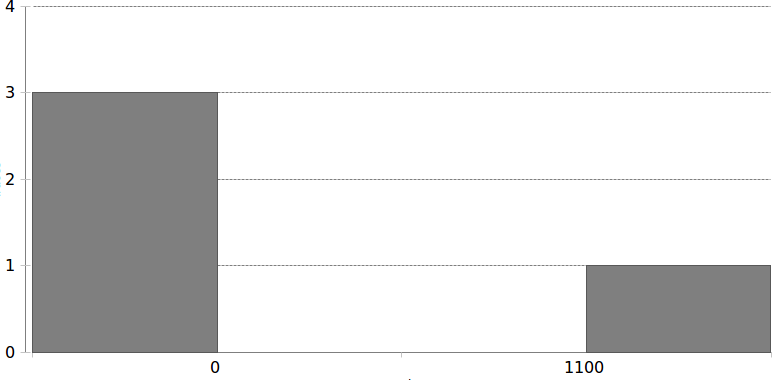

Hello everyone,
i am new to BIRT and need some advice.
I want to do a histogram, but i don't get this working. (see attachment)
I grouped the values for the chart manually into classes
(0-1100)(1100-2200).
chart is ChartWithAxes.
xAxisType is TEXT_LITERAL.
yAxisType is LINEAR_LITERAL.
The functions
chart.setUnitSpacing(0.0)
and
chart.setSeriesThickness(1100)
get called.
The last call seems to get ignored, cause there is a gap between the two
bars(see attachment).
I hope there is someone who can give me a hint how to fix this.
Kind regards
Matthias
Re: Histogram: Bar chart --- setUnitSpacing(0.0) [message #674010 is a reply to message #673931] Wed, 25 May 2011 09:56 Go to previous message
Hello again,
my fault was, that i added two BarSeries to the ySeries.
The values here where 0, so the bars where there, but not visible. ;)
Nevertheless, thanks a lot for reading my message.
