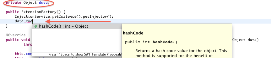

You mean something like this?
You enter 'cod' and completion engine returns 'hashCode' as depicted?

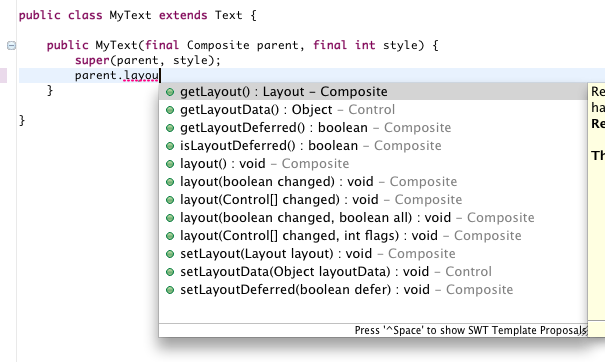

Maybe another (bit more clear) example.
Re: Fulltext autocompletion proposal [message #670773 is a reply to message #670771] Sun, 15 May 2011 09:17 Go to previous messageGo to next message
exactly!

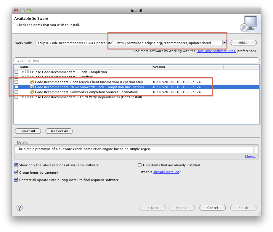

I just made the completion engine available on the HEAD update site. I dubbed it the "naive subwords completion engine" - please come up with a better name if you have one.
Just a few words on the implementation. It's a very simple one that helps you on completing method names only - it does not compute proposals for types, variable names etc. yet. There is no particular reason for this but I haven't found a perfect place to make this code work for every kind of completion yet. Also it's an untested monday afternoon hack...
To install this completion engine just add
http://download.eclipse.org/recommenders/updates/head/
to your list of update sites and install the
Code Recommenders: Naive Subwords Completion (Incubator)
from Sandbox category as depicted below.

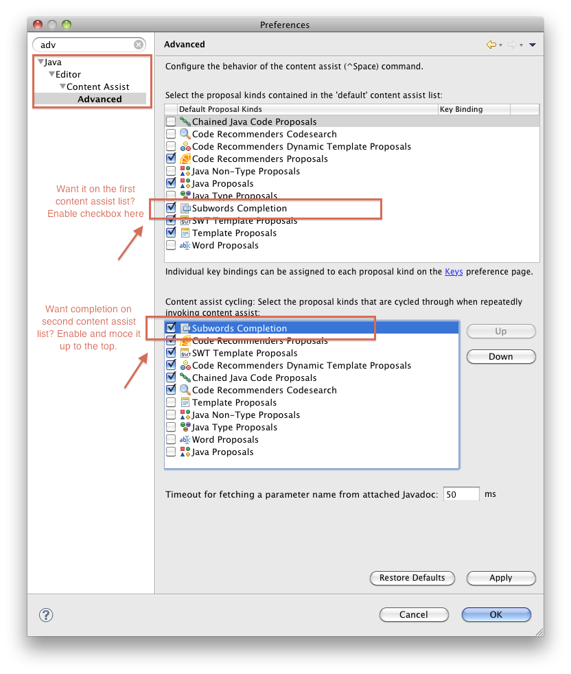

You may configure where/when Eclipse makes these proposals. Study the screenshot below for details.
