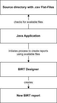

Hi everybody,
currently I am using the Birt Designer to manually create daily reports out of .csv Flat Files. Therefore I change the Flat-File name in the Query of the Data Set which can be found in the Properties of the Data Set. I cannot change the Flat-File name in the "Edit Data Set"-Window at the tab "Select Columns", because Birt will delete all existing columns from the old file but I want to keep these columns due to their name change and further use in the report.
My aim is to automatically create daily reports by using a Java Application that initiates that process. The short graphic of how the process should look is available in the file attachments.
Is there a possibility in Java to automatically change the Flat-File name in the Query and save the new report with a report name that includes the date used in the Flat-File name (or the current date)?
Or is there another solution?
Thank you,
Jochen
