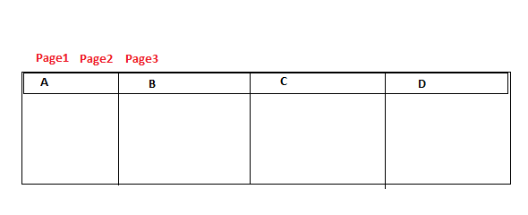

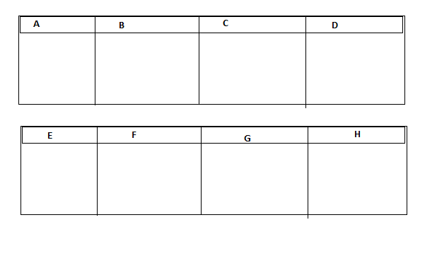

I tried the way you have mentioned here but it does not show the links to go to next page in HTML it is giving me a single html where i am getting complete html in one go.
And I see a display like PDF but I want to implement paging on the Html but this way it gives everything in single html. Is this the way it will work. see the attached screenshot. This screen represent two pages, which comes in single HTML.
What is the way to implement in the way shown in screenshot 2 (expectedPaging.png)
I have tried following properties
htmlOptions = HTMLRenderOption.new(options)
htmlOptions.setHtmlPagination(true)
htmlOptions.setHtmlRtLFlag(false)
htmlOptions.setDisplayFilterIcon(true)
htmlOptions.setEmbeddable(true)
Can you also tell me how can I embed the HTML to my page I made is true but what is the step further to render it on the page?
Thanks for the help
Shivani
