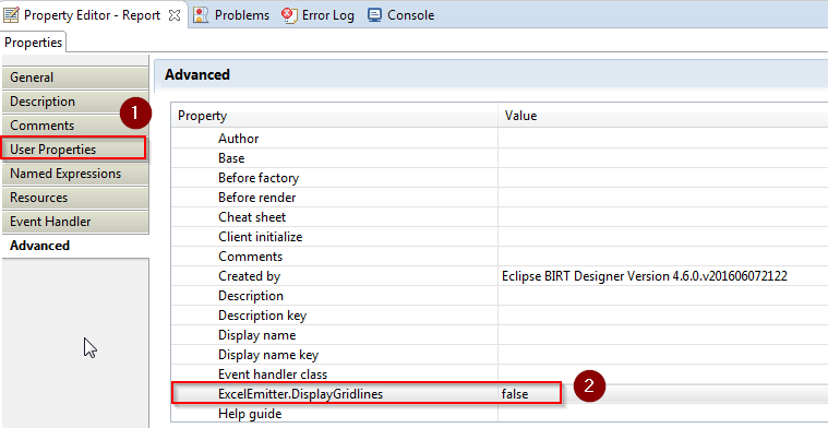

Re: Hide Excel Gridlines [message #1749011 is a reply to message #640649] Thu, 01 December 2016 01:59 Go to previous message
You can turn-off the gridlines the following way, if using Spudsoft emitter:
1. Add "ExcelEmitter.DisplayGridlines" as Boolean into BIRT document User Properties
2. Set this property to False in Advanced tab.
See screenshot below.
index.php/fa/27751/0/
