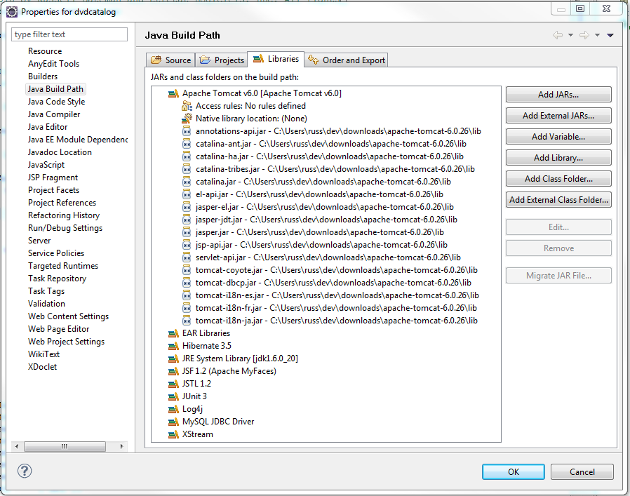

I may not be the best resource on this. What version of Eclipse are you
developing in?
In Eclipse, you're going to use Build Path to make known the libraries
you're using. In my example, which didn't use Tomcat so there may be a
difference, I made the path to the JNI (shared object) known to the one
JAR that consumed it. Eclipse did the rest such that, when flexlm.jar
code went to open it, it was there.
Eclipse sort of makes copies of the Tomcat libraries. The way Eclipse
deploys the application inside Eclipse (for debugging, running, etc.) is
to copy everything as if really deploying it to the path:
<workspace> /.metadata/.plugins/org.eclipse.wst.server.core/tmp0/wtpweba pps/...
where "..." is what you'd expect to find under Tomcat's webapps
directory. So, for the JARs, this would be
<application-name>/WEB-INF/lib. What you'll find there is all the
libraries you signed up for in Build Path including the Tomcat ones:
http://www.javahotchocolate.com/tutorials/tut-images/web-app -libs.png
....and all of the others (in this case, Hibernate, MyFaces JSTL, Log4j,
etc.) that aren't shown in this illustration.

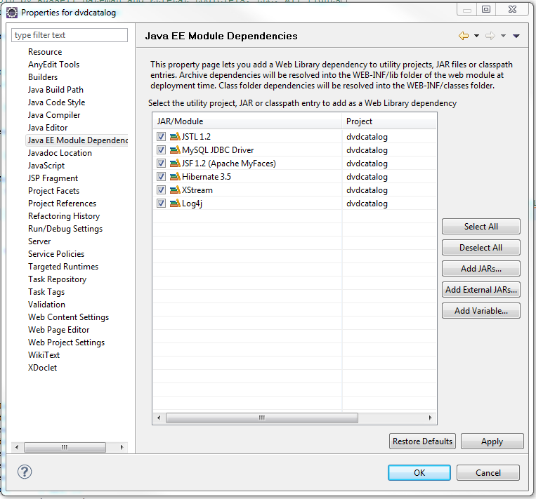

Last, this is influenced by marking a lot of the JARs in Build Path as
"Java EE Module Dependencies" as shown here. However, this stopped being
done this way in Galileo. It's done differently in Helios and I don't
know if that's relevant here.
http://www.javahotchocolate.com/tutorials/tut-images/web-app -module-dependencies.png
