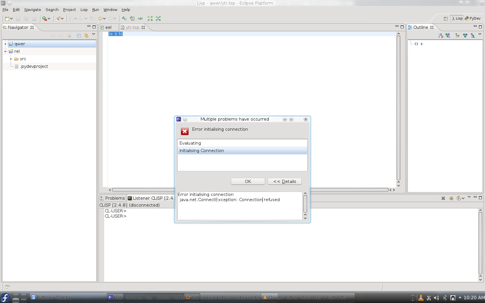

Hi I keep getting the same error, even after changing the folder to executable.
And I Use Fedora 15
  • Attachment: snapshot1.png
    (Size: 136.34KB, Downloaded 396 times)
