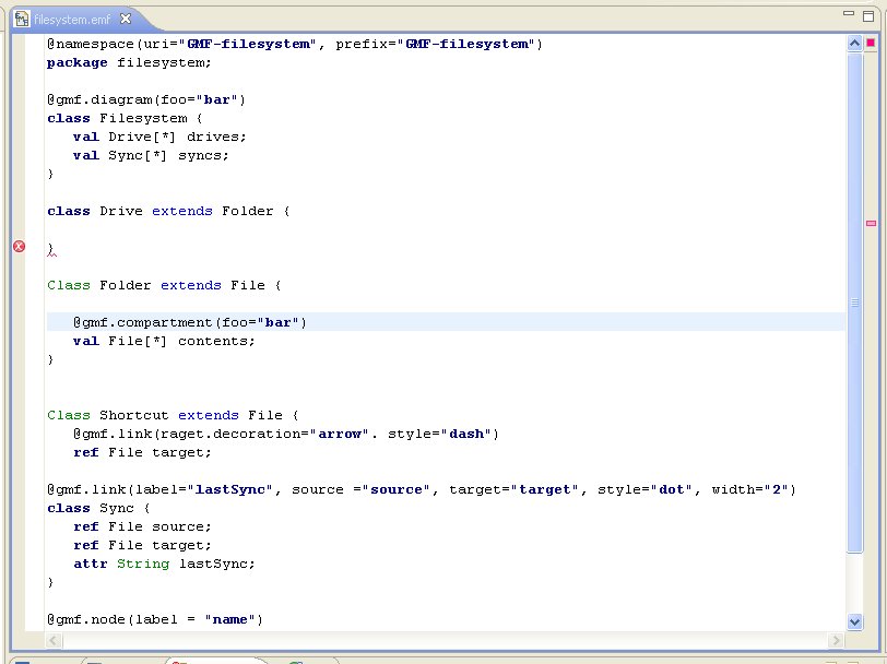

Re: Re running Eugenia Example- help required [message #855084 is a reply to message #854726] Tue, 24 April 2012 10:01 Go to previous messageGo to next message
All gmf lines have at least one annotation, if I understand your suggestion.
Attached (if I'd done it right) is a screen dump of what I see on my company PC. The hover text over the red 'x' reads:
Encountered "Class" at line 14, column 1.
Was expecting one of:
<EOF>
"package" ...
"abstract" ...
"class" ...
"interface" ...
"transient" ...
"datatype" ...
What now (to get this working)?
Julian.
Re: Re running Eugenia Example- help required [message #855267 is a reply to message #855084] Tue, 24 April 2012 12:58 Go to previous message
Hi Julian
just my 0.38 CZK (2c) - probably EMF is case sensitive and you have some class defined with capital C.
Ivo(sh)
