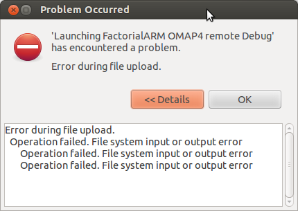

Hey, I've set up eclipse CDT with remote systems explorer and remote launch on my windows xp machine.
I have a code sourcery tool chain installed and can compile and build files locally on my machine for an arm cortex a8 processor.
I have set up the RSE with a Linux ssh sftp based connection and that all works in the explorer.
I have tried to set up the remote launch but I am having problems getting it to work.
The file is uploaded but doesn't have the correct permissions to be run and eclipse errors and says:
Error during file upload.
Operation failed. File system input or output error
If i run chmod 777 "file name" then ./"file name" on the remote machine then the file runs fine.

Re: Local Build, Remote Run / Debug [message #996509 is a reply to message #757467] Wed, 02 January 2013 03:58 Go to previous messageGo to next message
I am having the same problem. Using eclipse INDIGO - Version: 3.7.2
Build id: I20110613-1736.
shell connection is fine.
the executable is being copied to target but although I placed a chmod command before application execution I still get this error.
chmod 777 /path/to/application

Re: Local Build, Remote Run / Debug [message #1190180 is a reply to message #1085458] Sat, 16 November 2013 07:55 Go to previous messageGo to next message
Hi Daniel and said!
I have the same issue as you both.
Have you already found a solution?
I looked into the error log file and can provide some more information to this error:
org.eclipse.rse.services.files.RemoteFileIOException: Operation failed. File system input or output error

I made the same observations as Daniel, that the file is fully transferred to the target path, but the executable flag isn't set.
If I set the executable flag manually, the file can be executed successfully.
So the error log and my observation match.

Re: Local Build, Remote Run / Debug [message #1191878 is a reply to message #1085458] Sun, 17 November 2013 03:50 Go to previous messageGo to next message
Well, I have to admit that I'm really stupid.
As Yurij said, "full path", "not to its directory" is the solution.
I was so confused by the fact that the file was copied successfully,
that I wasn't able to read AND understand what Yurij said. Sorry.

Re: Local Build, Remote Run / Debug [message #1208053 is a reply to message #1191878] Sun, 24 November 2013 17:36 Go to previous messageGo to next message
I am having the exact same problem as the original poster, but specifying the full filepath does not solve the problem for me (ie. Rmote Absolute File Path for C/C++ Application:).
I am running eclipse Kepler under Ubuntu 13.10 and targeting a beaglebone ARM board.
The executable gets uploaded but executable permission is not set even though I have a chmod command set to execute before application.
If I manually set executable permission and run the file, it runs correctly.
One question, do I need to specify 'Remote workspace location:' from Connection:->Properties... ?
Thanks for any help, this is driving me nuts since it *almost* works.
-Randy
Re: Local Build, Remote Run / Debug [message #1334337 is a reply to message #1208053] Mon, 05 May 2014 10:21 Go to previous message
I had the same problem.
Spent the better part of Saturday and Sunday trying to fix it.
The answer is above in one of the previous replies.
I started with jkuhlm.bplaced.net/hellobone instructions.
What finally made it work was to set
"Remote Absolutute File Path for C/C++ Application:" to
"/home/ubuntu/workspace/bone/Release/hellobone"
The name of the executable is "hellobone" as in the example above.
"Commands to execute before application"
has been left blank. I find it is not necessary.
Hope this helps.
