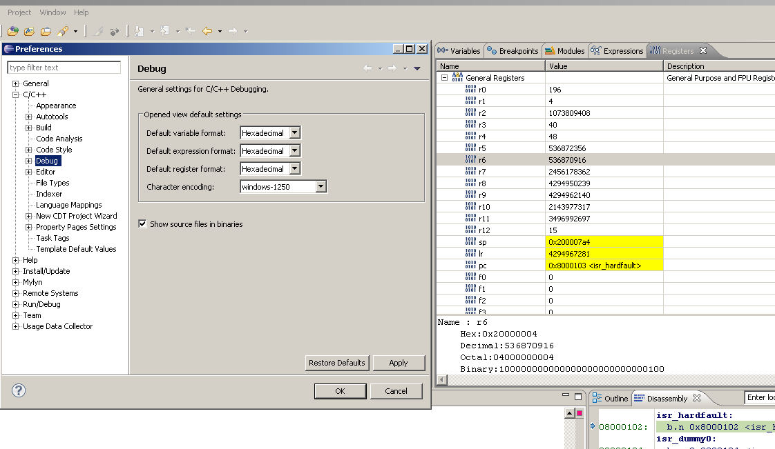

I would like to reopen this topic. I use Eclipse for ARM development. My version is
Version: Indigo Release
Build id: 20110615-0604
and CDT version 201106081058
I tried what people had recommended here but without success. Screen-shot is attached. I even have no right-click menu with "Format" option on the registers' values.
Can anybody help me what is wrong?
Thank you in advance.

Re: Change debug register display to hexadecimal? [message #814505 is a reply to message #742244] Tue, 06 March 2012 09:33 Go to previous messageGo to next message
Hello
I have the same problem as vaclavpe.
Does anybody know how to change display format when there is no Format Display menu after "righ click" and settings in preferensces seems to be useless??
Thanks in advance
Simon.

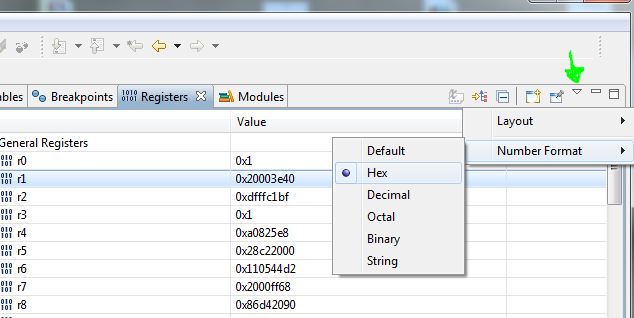

Re: Change debug register display to hexadecimal? [message #990419 is a reply to message #543536] Wed, 12 December 2012 07:26 Go to previous messageGo to next message
I have the exact same problem with the version of Eclipse used in the CodeSourcery CodeBench release (with CDT 8.1.0.394665) - preferences setting appears not to work very well - some registers now in hex, but seemingly according to some attempt to "intelligently" decide how to display them - and, more annoyingly, no right-click context menu "format" option (this option has been present on other Eclipse spins, such as CCS).
Anyone had this problem who knows how to fix it - in particular, how to recover the context menu "format" functionality?
Thanks!
- Carl
Re: Change debug register display to hexadecimal? [message #990451 is a reply to message #543536] Wed, 12 December 2012 09:45 Go to previous message
Answering my own "me too", which hasn't cleared moderation yet: turns out the CodeSourcery version, at least, has an inconspicuous down-facing-triangle drop-down menu icon third from the right in the button bar of the variable/register/breakpoint pane, between the "minimize" and "pin to debug" items. This has two sub-menus, Layout and Number Format. Number Format in this menu actually works (unlike the one in the Window...Preferences...C/C++...Debug pane.)
index.php/fa/12678/0/
It changes all the registers, or variables, or whatever, but in the absence of the context menu "format" item, it at least saves a measure of frustration.
