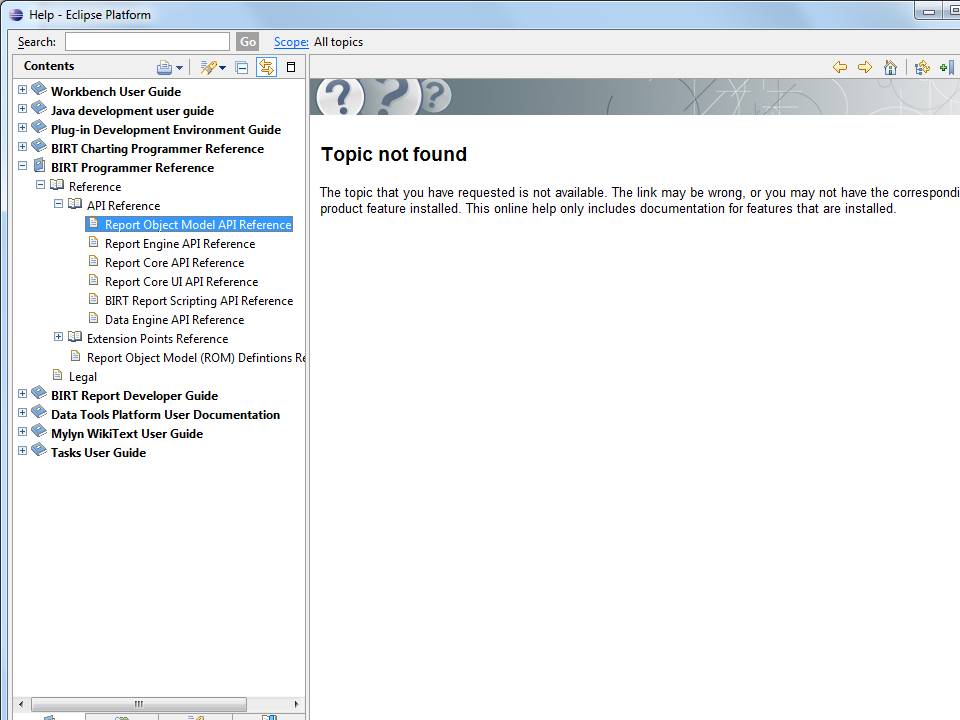

Re: Where do I find BIRT Charting Programmer Reference or BIRT Programmer Reference? [message #766054 is a reply to message #765791] Thu, 15 December 2011 01:30 Go to previous messageGo to next message
index.php/fa/6482/0/Hello,
I copied the folders:
C:\source_BIRT_2_6_1_Release_201009151750\source_BIRT_2_6_1_Release_201009151750\features\org.eclipse.birt.chart.doc.isv.feature
C:\source_BIRT_2_6_1_Release_201009151750\source_BIRT_2_6_1_Release_201009151750\features\org.eclipse.birt.doc.feature
C:\source_BIRT_2_6_1_Release_201009151750\source_BIRT_2_6_1_Release_201009151750\features\org.eclipse.birt.doc.isv.feature
to the folder
C:\birt-report-designer-all-in-one-2_6_1\eclipse\features
and the folders:
C:\source_BIRT_2_6_1_Release_201009151750\source_BIRT_2_6_1_Release_201009151750\org.eclipse.birt.chart.doc.isv
C:\source_BIRT_2_6_1_Release_201009151750\source_BIRT_2_6_1_Release_201009151750\org.eclipse.birt.doc
C:\source_BIRT_2_6_1_Release_201009151750\source_BIRT_2_6_1_Release_201009151750\org.eclipse.birt.doc.isv
to the folder
C:\birt-report-designer-all-in-one-2_6_1\eclipse\plugins
When I opened the Eclipse I got the error message. See the attachment picture.
Where I am doing wrong??
BR,
Mika
  • Attachment: birtHelp.jpg
    (Size: 67.54KB, Downloaded 1194 times)
[Updated on: Thu, 15 December 2011 01:34] by Moderator
Re: Where do I find BIRT Charting Programmer Reference or BIRT Programmer Reference? [message #766327 is a reply to message #766054] Thu, 15 December 2011 10:00 Go to previous messageGo to next message
What download did you use? I used the source download that is available
as a zip. birt-source-2-6-1.zip. I extracted it and copied the following:
birt-source-2-6-1\features:
to
and
birt-source-2-6-1\plugins:
to
Jason

Re: Where do I find BIRT Charting Programmer Reference or BIRT Programmer Reference? [message #767997 is a reply to message #766901] Mon, 19 December 2011 05:51 Go to previous messageGo to next message
Now "BIRT Programmer Reference" is working in the Eclipse, but the PDF printing doesn't contain the javadoc. Is it possible to get the full documentation in the PDF?
Currently I don't need the chart documentation, but it wasn't working correctly. All 3 API documentation (Chart Engine API Reference etc.) created "Topic not found" error message.
BR,
Mika
[Updated on: Mon, 19 December 2011 06:18] by Moderator
Re: Where do I find BIRT Charting Programmer Reference or BIRT Programmer Reference? [message #768016 is a reply to message #766901] Mon, 19 December 2011 06:58 Go to previous messageGo to next message
BR,
Mika

Re: Where do I find BIRT Charting Programmer Reference or BIRT Programmer Reference? [message #768442 is a reply to message #768137] Tue, 20 December 2011 01:52 Go to previous messageGo to next message
1) BIRT Charting Programmer Reference
Here is a part of the Eclipse log for the Charting Programmer Reference:
!ENTRY org.eclipse.help.base 4 4 2011-12-19 13:14:29.957
!MESSAGE Help documentation could not be indexed completely.
!SUBENTRY 1 org.eclipse.help.base 4 4 2011-12-19 13:14:29.958
!MESSAGE Help document /org.eclipse.birt.chart.doc.isv/chartui/api/index.html cannot be opened.
!MESSAGE Help document /org.eclipse.birt.chart.doc.isv/chartscript/api/index.html cannot be opened.
!MESSAGE Help document /org.eclipse.birt.chart.doc.isv/chart/api/index.html cannot be opened.
How to create the Charting Programmer Reference?
2) BIRT Programmer Reference
I'm sorry I didn't understand. Could you explain this
open an enhancement to make the
java docs available as a pdf download
Is it possible to get complete "BIRT Programmer Reference" from the Eclipse help in the PDF format?
BR,
Mika
