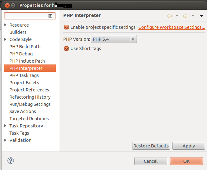

2. Make your project use php 5.4 (or higher). View images
index.php/fa/17505/0/
