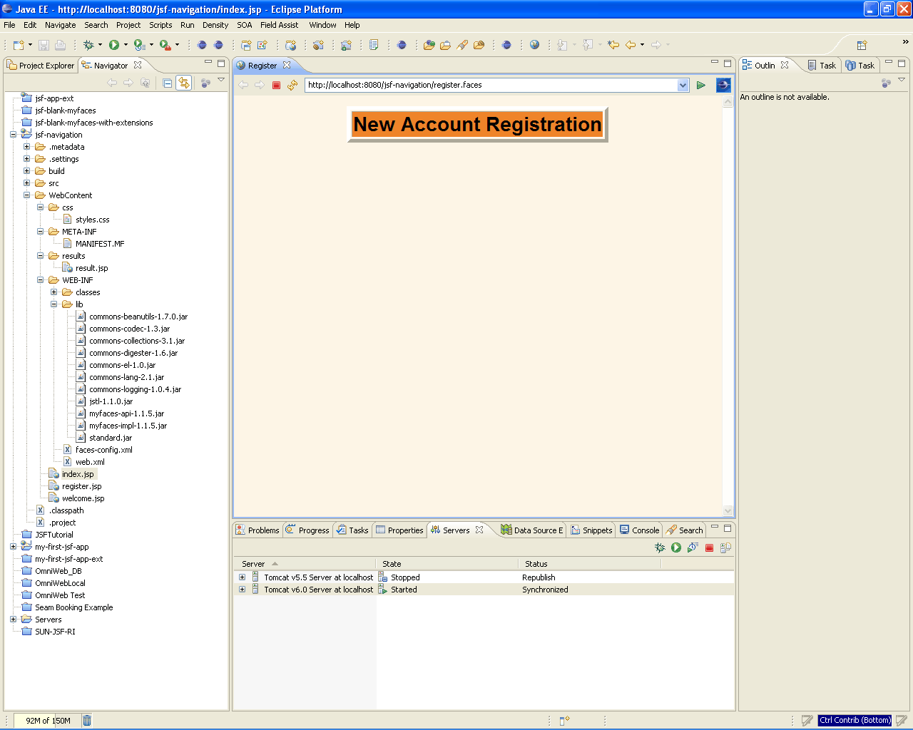

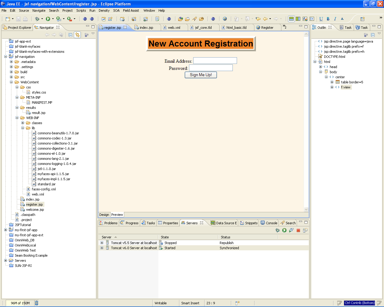

and the problem is that when I am working on a JSF page in the Eclipse
editor it is rendering fine as shown in the attachments.

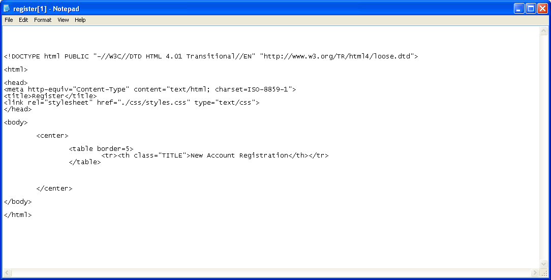

However when I run it in my Tomcat server (Tomcat 6.x), everything inside
the <f::view> tag does not render. I have validated this by moving certain
standard HTML tags and have indeed narrowed it down to everything inside the
<f:view> tag. The page that gets rendered is also shown in one of the
attachments, including the actual source view of that page.

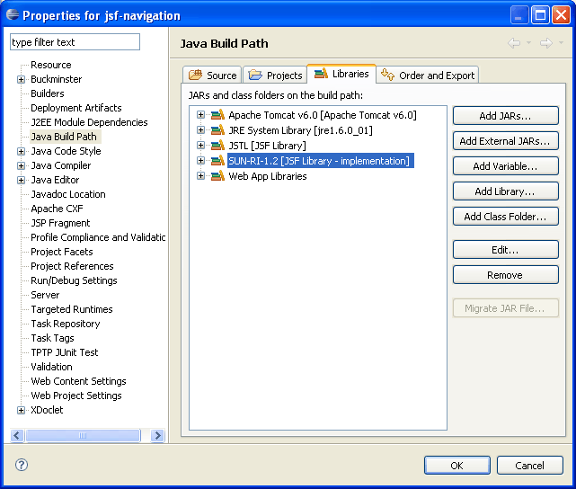

Are there any errors showing up in the Tomcat logs? Also, I notice that
you seem to have defined a JSF Library using Sun implementation jars, but
have MyFaces implementation jars in the WEB-INF/lib directory. I suspect
that you probably have some kind of Tomcat/MyFaces configuration issue that
would be best answered on one of those newsgroups.

Actually that is exactly what I did, started from scratched and redefined
the JSF implementation library and then created the JSF project from there.
The new project seemed to work fine with the new JSF library definition so I
then recreated the tutorial project from there.
Seemed to work, not exactly sure why (which I hate when I can't explain why
things just happen to start working) but works now nonetheless.
Probably just some sort of funky problem with the JSF library not being
defined 100% correct or being deployed to the RTE Tomcat properly.
