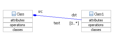

I attached a snapshot of the association I'm trying to implement..Is this
invalid?
The error I get is "The multiplicity of composite aggregation '<Property>
dst : Class1 [0..*]' has an upper bound greater than 1."
Why is this invalid? Is there another way to implement it?
Nikos

Hi Nikos,
If the multiplicity of src is 1 then this is a valid diagram. The
isComposite of dst should be true and the isComposite of src should be
false.
Can you verify that?
You might have a display issue? If the multiplicity of src was * and the
composition was the other way, then I would expect that error.
Can you post your model and I'll give it a look over.
- James.

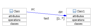

Hi James,
The multiplicity of src is 1. I couldn't find the isComposite attribute on
either dst or src.
I use Eclipse Version 3.3.0, Build id I20070222-0951 and UML2 v.2.1M5.
I attach both the UML2 model and the corresponding diagram.

> >> Hi James,
this
> >> invalid?
'<Property>
> >> Regards,
> >> Nikos

Re: UML2 Composite Association Bug? [message #471728 is a reply to message #471727] Mon, 19 March 2007 14:38 Go to previous messageGo to next message
Originally posted by: nikos.swen.uwaterloo.ca
Hi James,
I did what you suggested but then the diagram looks like the one I attached,
but this in not what I want. The diamond of the composition should be on the
src side but instead it is shown in the dst side. All I want to implement is
an aggregation (from src to dst) which will have cardinality 1 at the src
side and 0..* at the dst side. Could you create one and send me the model
and the .umlclass_diagram plz? I still think there is a problem. I use the
uml2tools to implement the diagrams.
Nikos

Re: UML2 Composite Association Bug? [message #471729 is a reply to message #471728] Mon, 19 March 2007 15:27 Go to previous messageGo to next message
Hi Nikos,
There is a bug in uml2tools in how it displays these things ... the diamond
is on the wrong side :) Please raise a bugzilla on them to get that fixed.
By the way, in general "Class" should also probably own the composed
property ( not the association ) as your serialized version shows.
- James.
Thank you for your time James. Since the uml2tools contains bugs could you
suggest a tool (freeware of course) in which you can graphically create
efficiently UML2 diagrams? I need to create UML2 diagrams and then transform
them (the models) to ecore files and finally create EMF editors for those.
Thank you,
Nikos

> Hi Nikos,
> diamond
> fixed.
> Regards,
> - James.

>> Hi James,
> attached,
> the
> is
>> the
>> Regards,
>> Nikos

>> > I just had a look at the serialized version. Looks like your
>> > composite
>> > aggregation is on the wrong side. ... ie, your picture does not
>> > reflect
>> > what you have in the serialized version.
>> > Have a look at src, aggregation=composite. That should be on the
>> > dst
>> > side... (the isComposite is derived so it is not serialized out but you
>> > could use the API).
>> > You can simply try to cut and paste that attribute over and it should
>> > validate fine :)
>> > Regards,
>> > - James.
>> >> attribute
>> >> on
>> >> either dst or src.
>> >> >> implement..Is
>> > this
>> >> >> invalid?
>> > '<Property>
>> >> >> Regards,
>> >> >> Nikos
> Thank you,
> Nikos
> "James Bruck" <jbruck@ca.ibm.com> wrote in message
> news:etmo6v$tsu$2@utils.eclipse.org...
>> Hi Nikos,
>> diamond
>> fixed.
>> Regards,
>> - James.
The TopCased UML editor (www.topcased.org) has the same behaviour as
uml2tools. I'm getting suspicious...
Aggregration=Composite is now on the src side, where src points to the
"owner" classifier in the association. In UML 1.4, this is similar:
association ends that point to the "owner" classifier are marked as
ak_composite. Poseidon for UML implemented it this way.
> The constraint in the spec is in section 7.3.43 : [2] A multiplicity on an
> aggregate end of a composite aggregation must not have an upper bound
> greater than 1. isComposite implies (upperBound()->isEmpty() or upperBound()
> <= 1)
Ah, natural language... I interpret:
aggregate end of a composite aggregation = src
The multiplicity of src is indeed 1, since there should only be one
owner for any object. So, src->isComposite() must be true.
It is feasible for the src classifier to own multiple instances of the
dst classifier. Hence, the multiplicity of dst may be greater than 1.
Given the constraint from the UML spec, dst->isComposite() must be false.
Looks like UML2 intended the same semantics for Property elements as UML
1.4 did for AssociationEnd elements. Can you verify this please? It
would mean that Nikos was right.
Dennis

Take just about any figure in the UML spec illustrating the UML metamodel.
For instance, from the 07-02-05 version take figure 12.22 for structured
nodes.
Notice the composition association between ConditionalNode and OutputPin.
ConditionalNode has a part called "result" of multiplicity [*]. "result"
is shown on the end that is opposite the diamond along with the [*]
multiplicity. Also, on the end with the diamond we have the multiplicity
[0..1]. The isComposite() of "result" would be true in that case and is
shown on the dst end.
If what you are implying is correct then I think that means that all the
diagrams in the spec are backwards.
I agree that the constraint from the spec that is quoted below does seem to
be worded imprecisely.
.... are you convinced ?.... :)
p.41 of the spec describes the notation.
- James.
Hi James,
invalid?
Nikos

Re: UML2 Composite Association Bug? [message #599682 is a reply to message #471723] Mon, 19 March 2007 13:18 Go to previous message
Hi Nikos,
false.

Re: UML2 Composite Association Bug? [message #601771 is a reply to message #471724] Mon, 19 March 2007 13:28 Go to previous message
Hi James,
either dst or src.
Ragards,
Nikos
'<Property>
> >> Regards,
> >> Nikos

Hi James,
Nikos
>> > false.
> the
>> > Regards,
>> > - James.

Hi Nikos,
- James.
> Hi Nikos,
> diamond
> fixed.
> Regards,
> - James.

>> Hi James,
> attached,
> the
> is
>> the
>> Regards,
>> Nikos

>> > "Nikos Giannopoulos" <nikos@swen.uwaterloo.ca> wrote in message
>> > news:etmh8g$81s$1@utils.eclipse.org...
>> >> Hi James,
>> >> attribute
>> >> on
>> >> either dst or src.
>> >> Ragards,
>> >> Nikos
>> >> news:etmgle$6qb$2@utils.eclipse.org...
>> >> > Hi Nikos,
> be
>> >> > false.
> and
>> > the
>> >> > Regards,
>> >> > - James.
>> >> > news:etmdtu$vup$1@utils.eclipse.org...
>> >> >> Hi James,
>> >> >> implement..Is
>> > this
>> >> >> invalid?
>> > '<Property>
>> >> >> Regards,
>> >> >> Nikos
>> >> >> news:etmce4$rup$2@utils.eclipse.org...
>> >> >> > Hi Nikos,
>> >> >> > It sounds like you are modifying the cardinality to * of the
> Regards,
> Dennis
Re: UML2 Composite Association Bug? [message #604215 is a reply to message #472103] Mon, 02 April 2007 18:05 Go to previous message
Hi Dennis,,
After re-reading that constraint ... I can really understand the confusion
about this point. I just spoke to Bran Selic ( chair of OMG ) to clarify
that for me and there does seem to be an issue there that should be cleaned
up. He mentioned that there were long debates over this point but the way
the UML API implements this constraint is correct. Have a look at the
PropertyOperations.validateMultiplicityOfComposite() for the proper
implementation.
When I come across the RTF (defect number) for that issue I will post it
here.
.... so I still stick to the original response that I gave :)
I hope that helps.
- James.
news:eurtb8$vbj$2@build.eclipse.org...
> Hi Dennis,
> ... let me try to convince you ... :)
> nodes.
"result"
>>>>>>> Hi Nikos,
>>>>>>> diamond
>>>>>>> fixed.
>>>>>>> Regards,
>>> composed
>>>>>>> - James.
