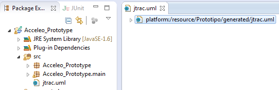

Re: Best Way to Import Existing UML model into Papyrus [message #994766 is a reply to message #994666] Fri, 28 December 2012 03:06 Go to previous messageGo to next message
inside your project you should see all the files that you have, even if you have an uml file, agree?
I think that this is the same in most of the perspectives. See the attached file, I am using the java perspective, with the package view
hope it helps
