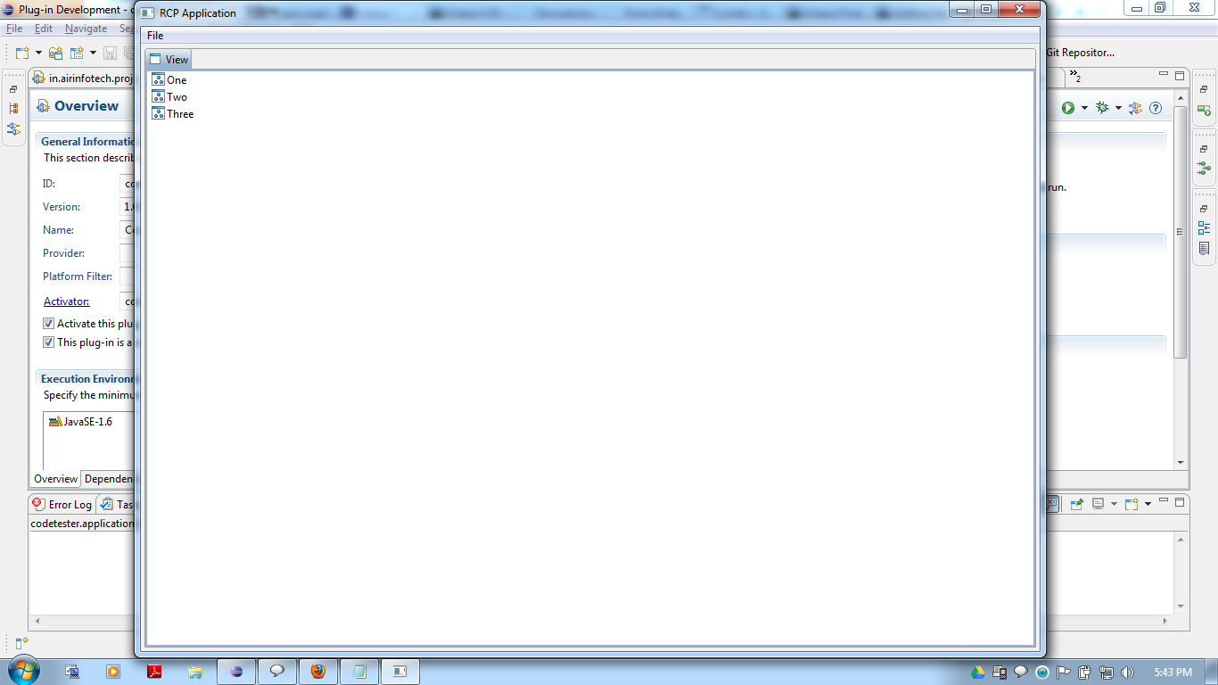

calling
shell.setMaximized(true)
in
createWindowContents()
works fine without making the application window flicker. But it makes the application open similar to restore mode in Windows environment and not maximized.
( see sample output image. My Eclipse IDE is in maximized state and the application window appears )
I am developing on Windows 7 and Eclipse Indigo.
