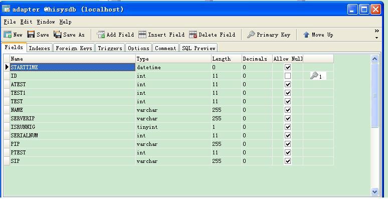

Hello James,
In my application,I define an entity class and a class implements DescriptorCustomizer,
@Entity
@Table(name = "adapter")
@Customizer(OrderCustomizer.class)
public class AdapterRecord implements Comparable<AdapterRecord>, Serializable
	private static final long serialVersionUID = 1L;
	@Id
	@GeneratedValue(strategy = GenerationType.AUTO)
	private int id;
	private String name;
	private int serialNum;
	private boolean isRunnig;
	private String serverIp;
	@Temporal(TemporalType.TIMESTAMP)
	private Date startTime;
	private int test;
	private int test1;
	private int ptest;
	private String pIp;
	private String sIp;
	private int aTest;
public class OrderCustomizer implements DescriptorCustomizer
	public void customize(ClassDescriptor descriptor)
		descriptor.setShouldOrderMappings(false);
I want the columns in a particular order - the order in which the
fields appear in the Entity class definition.
But when I run the application ,I got columns order :
index.php/fa/4248/0/
starttime,
id,
atest,
test1,
test,
name,
serverip,
isrunning,
serialnum,
pIp,
ptest,
sip
Could you give me some help ? Thanks a lot.
Boyd
  • Attachment: columns.JPG
    (Size: 51.96KB, Downloaded 971 times)
