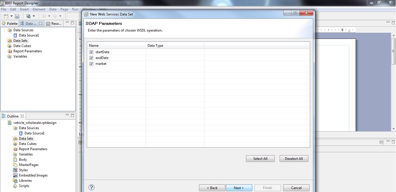

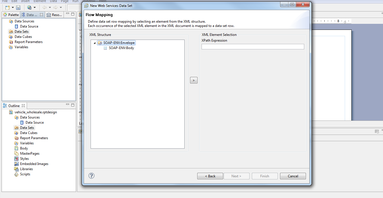

I've gone through the weather service demo and it works fine. I first tried
creating an axis2 web service using WTP and it worked as expected with a
java client. However in BIRT it connects ok as a data source but has issues
when defining a dataset. The input parameters show up but the table mapping
only shows "return" and not the xml data so the columns can't be mapped. So
I designed the web service in C#/ASP.NET and installed in on IIS. In this
case the table mapping page showed the xml structure and I was able to map
the output columns. I was able to open the service in a browser, enter
parameters and on clicking invoke it returned the xml response data set as
expected. However clicking on preview results in the data set editor fails
with a birt exception with the server returning HTTP 400.

Jim,
If you preview the report does it retrieve your data?
Also did you get anything in the workspace log file when you got the 400
error?
Jason

Hi Jason,
I did try a preview and got the same error information which is what is
shown in the log file included below. The request in the data source looks
to be the same as the sample post request shown on the asp.net page:
<?xml version="1.0"? encoding="utf-8">
<SOAP-ENV:Envelope
xmlns:SOAP-ENV="http://schemas.xmlsoap.org/soap/envelope/"
xmlns:SOAP-ENC="http://schemas.xmlsoap.org/soap/encoding/"
xmlns:xsi="http://www.w3.org/2001/XMLSchema-instance"
xmlns:xsd="http://www.w3.org/2001/XMLSchema">
<SOAP-ENV:Body>
<m:getNPTDataItems xmlns:m="http://com.test/services/2008/09">
<m:startDate xsi:type="xsd:dateTime">&?startDate?&</m:startDate >
<m:endDate xsi:type="xsd:dateTime">&?endDate?&</m:endDate>
<m:siteId xsi:type="xsd:string">&?siteId?&</m:siteId>
<m:machineId xsi:type="xsd:string">&?machineId?&</m:machineId>
<m:operatorId xsi:type="xsd:string">&?operatorId?&</m:operatorId >
</m:getNPTDataItems>
</SOAP-ENV:Body>
</SOAP-ENV:Envelope>
At this point I can't rule out some .net permission problem although the
ping test succeeds and the wsdl is retrieved.
Jim

Re: Web Service Data Sources [message #691054 is a reply to message #365472] Thu, 30 June 2011 11:56 Go to previous messageGo to next message
Hello, I'm having a similar issue. I removed the dateTime parameters from my wsdl, made them strings instead. Now I'm getting a new error. I also can't get a preview to work, I generally get the same errors as when I'm running it on my server. Hopefully someone can help me, I have no idea how to fix this. Posting the stacktrace here (hope that's ok). It's saying no protocol, but I'm not sure what that means or what it relates to??
Thank you.

Re: Web Service Data Sources [message #691067 is a reply to message #691054] Thu, 30 June 2011 12:11 Go to previous messageGo to next message
Is this a report that you could post and is the web service public?
Attached is an example Web Service report, although the web service is
public it is slow.
Jason
> relates to??
> Thank you.
> 17:44:40,447 INFO [ReportManagerBean] Running report generation task
> 17:44:45,201 WARNING [ModelAdapter] handle type:
> org.eclipse.birt.report.model.api.OdaDataSetHandle
> 17:44:46,653 SEVERE [odaconsumer] Cannot execute statement.
> org.eclipse.datatools.connectivity.oda.OdaException: no protocol: at
> org.eclipse.datatools.enablement.oda.ws.util.RawMessageSender.getSOAPResponse(RawMessageSender.java:107)

Re: Web Service Data Sources [message #698922 is a reply to message #694439] Wed, 20 July 2011 09:30 Go to previous messageGo to next message
Hi Jason,
I'm sorry, after days of banging my head against a wall i have a working web service. I've tested it with SoapUI and it works perfectly.
Birt problem: When creating the web service dataset, is there any reason why Birt would be able to see the input parameters, but when it gets to row mapping the
SOAP-ENV:Body has nothing inside it? So I can't do the row mapping??
I'll attach the wsdl, the bean and the an image of what I'm talking about.
Deesha
[Updated on: Wed, 20 July 2011 09:54] by Moderator
Re: Web Service Data Sources [message #698984 is a reply to message #698922] Wed, 20 July 2011 11:18 Go to previous messageGo to next message
Deesha
Can you post the SOAP request gui page from the dataset editor?
Did you use a dataset parameter(&?dsparm?&) or hardcode the parameter
value?
Jason

Re: Web Service Data Sources [message #699252 is a reply to message #698984] Thu, 21 July 2011 04:02 Go to previous messageGo to next message
The wsdl was created using an xsd, and somehow BIRT just sees the input parameters but nothing else :/
I didn't have to code anything into BIRT. The input parameters were just there, and i ticked them and it created the following request:
<?xml version="1.0"?>
<SOAP-ENV:Envelope
xmlns:SOAP-ENV="http://schemas.xmlsoap.org/soap/envelope/">
<SOAP-ENV:Body>
<m:VehicleWholesaleRequest xmlns:m="http://vls.com/VLS/Service/1.0">
<m:startDate xsi:type="xsd:string">&?startDate?&</m:startDate>
<m:endDate xsi:type="xsd:string">&?endDate?&</m:endDate>
<m:market xsi:type="xsd:string">&?market?&</m:market>
</m:VehicleWholesaleRequest>
</SOAP-ENV:Body>
I'm just wondering, should I create an external xml with the response format? Would that work? I think I can pick that out of SoapUI somehow..
Deesha

Re: Web Service Data Sources [message #699442 is a reply to message #699252] Thu, 21 July 2011 10:35 Go to previous messageGo to next message
Ok this created three dataset parameters when you clicked them. Did you
set values for the parameters using the dataset editor's parameter tab
while in the web service dataset?
Jason
> <SOAP-ENV:Envelope
> <SOAP-ENV:Body>
> </SOAP-ENV:Body>
> Regards,
> Deesha
