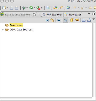

i'm trying to create a jdbc connection profile for mysql.
So i go into the datasource explorer, click on Databases, SQL Model-JDBC
Connection, fill in the name/description, and then the driver selection
screen.
It asks to select a driver from the dropdown. the button on the right
shows me a list of available driver definitions, i choose mysql 5.0 and
click ok.
however, when i click ok, the driver selection screen goes away and
still no driver is selected in the drop-down.
also, when i enter the database, username and password, and click finish
or next, nothing happens. the buttons don't react.
the only one that reacts is "cancel" or "back". "Cancel" closes the
screen and "back" goes back one screen.
I guess this is not normal behaviour. However, i have the plugins in the
plugins directory and according to help/software updates/manage
installation/product configuration, i have all DTP, GEF and EMF
features. there's no cross to indicate a faulty module.
However, my mysql installation is just fine. i can connect with MAMP,
myphpadmin and cocoamysql to /Applications/MAMP/tmp/mysql/mysql.sock
can anyone help pls?
cheers,
Andy

i found a lead : first i have to add a driver definition in the
preferences. so i added
/library/Java/extensions/mysql-connector-java-5.0.7-bin.jar
with the following standard parameters for my test db :
connection url : jdbc:mysql://localhost:3306/database
database name : avathar_be
user name : root
password : root
however, when i use that profile in data source explorer, i get
com.mysql.jdbc.exceptions.MySQLSyntaxErrorException: Unknown database
'database' at
com.mysql.jdbc.SQLError.createSQLException(SQLError.java:936 ) at
com.mysql.jdbc.MysqlIO.checkErrorPacket(MysqlIO.java:2985) at
com.mysql.jdbc.MysqlIO.checkErrorPacket(MysqlIO.java:885) at
com.mysql.jdbc.MysqlIO.secureAuth411(MysqlIO.java:3421) at
com.mysql.jdbc.MysqlIO.doHandshake(MysqlIO.java:1247) at
com.mysql.jdbc.Connection.createNewIO(Connection.java:2748) at
com.mysql.jdbc.Connection.<init>(Connection.java:1553) at
com.mysql.jdbc.NonRegisteringDriver.connect(NonRegisteringDr iver.java:285
) at
org.eclipse.datatools.connectivity.db.generic.JDBCConnection .createConnec
tion(JDBCConnection.java:87) at
org.eclipse.datatools.connectivity.DriverConnectionBase.inte rnalCreateCon
nection(DriverConnectionBase.java:104) at
org.eclipse.datatools.connectivity.DriverConnectionBase.open (DriverConnec
tionBase.java:53) at
org.eclipse.datatools.connectivity.db.generic.JDBCConnection Factory.creat
eConnection(JDBCConnectionFactory.java:52) at
org.eclipse.datatools.connectivity.internal.ConnectionFactor yProvider.cre
ateConnection(ConnectionFactoryProvider.java:77) at
org.eclipse.datatools.connectivity.internal.ConnectionProfil e.createConne
ction(ConnectionProfile.java:354) at
org.eclipse.datatools.connectivity.ui.PingJob.run(PingJob.ja va:57) at
org.eclipse.core.internal.jobs.Worker.run(Worker.java:55)

ok it works now. my connectiono url wasnt right
should have been jdbc:mysql://localhost:3306/avathar_be
now im gonna test further ;)

Re: Connection wizard - Picture 1.png (1/1) [message #587902 is a reply to message #36310] Sat, 15 September 2007 07:03 Go to previous message
Originally posted by: nova67f.yahoo.de
In article <nova67f-3197AB.12300015092007@news.eclipse.org>,
Andy Vandenberghe <nova67f@yahoo.de> wrote:
> In article <nova67f-7EAEA8.11421615092007@news.eclipse.org>,
> > Hi,
> > screen.
> > click ok.
> > cheers,
> > Andy
> user name : root
> password : root
> 'database' at
> ) at
cheers,
Andy
