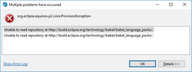

Unfortunately, we were unable to preview the progress of our translation because we had this error
Can you help us?
Thank you, Caio.
Re: Babel Eclipse Project translation process [message #1786629 is a reply to message #1786627] Tue, 08 May 2018 15:13 Go to previous messageGo to next message
Our nightly build process seems to be broken. I will look into that.

Re: Babel Eclipse Project translation process [message #1786699 is a reply to message #1786632] Wed, 09 May 2018 11:21 Go to previous messageGo to next message
Our Nightly build process seems to have completed successfully:
This Eclipse update site should work for you:
http://build.eclipse.org/technology/babel/update-site/N20180509-0200/oxygen/
Or this one:
http://build.eclipse.org/technology/babel/update-site/I20180508-1500/oxygen/
