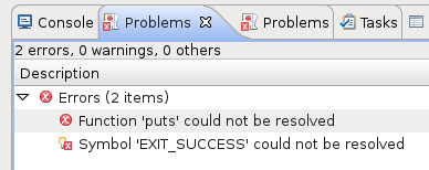

I tried making a makefile project from existing code. When I edit, I constantly get errors indicating that the include files weren't recognized (such as: Function can't be resolved). So, I figured I'd make a corresponding Hello World project using the wizard to see the "right" way. I get the same problem from the very beginning.
There are no error flags on the include files so I assume they are being found. It just seems they aren't being considered.
Is there something special I need to do to make this work? I've tied searching for similar problems but only found non-applicable ones or those with no answers. This is very puzzling and I'd hate to have to convert what I have to individual projects.
DAV
#include <stdio.h>
#include <stdlib.h>
int main(void) {
puts("Hello World!!!");
return EXIT_SUCCESS;
Description Resource Path Location Type
Function 'puts' could not be resolved Hello.cpp /Hello line 13 Semantic Error

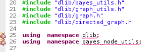

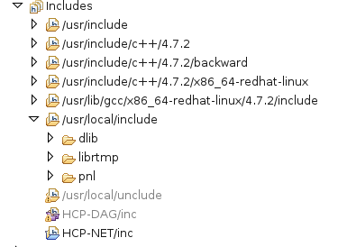

Re: Function can't be resolved error [message #1000897 is a reply to message #1000769] Tue, 15 January 2013 11:38 Go to previous messageGo to next message
John is getting the same errors as I am. It also doesn't explain why the example I posted above exhibits similar problems. In my case, the includes are already in the include path.
I've attached a typical error and a snap of the includes list. I'm at a loss as to what else can be done.
BTW: notice the "/usr/local/unclude"? I had misspelled "include" when I added the path as you suggested. I subsequently edited the entry but now there's an entry I'm not allowed to delete.
UPDATE: The undeletable path was cute at first but it's beginning to be annoying. I can't compile because its not a valid path. I can't delete it because it's greyed out. It's not being kept in the .cproject file with the rest of the includes I've added yet I can export it. ARRGH! So, maybe the problem with the Code Analysis is because there are apparently multiple lists of include files (which IMO is not very good design)?
UPDATE2: Well, I found the phantom include in the g++ command lines contained in the *.sc and *_scd.mk files. After I edited those, the "unclude" disappeared. Something else to add to the test suite assuming there is one.

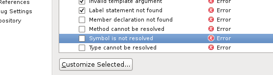

Re: Function can't be resolved error [message #1000909 is a reply to message #1000897] Tue, 15 January 2013 12:07 Go to previous messageGo to next message
I turned off the last four boxes in the Code Analysis dialog (see below). Not the best solution but at least it got rid of the annoying, incorrect flags. Perhaps someone will come up with a better solution.
  • Attachment: codeanal.png
    (Size: 10.51KB, Downloaded 978 times)
